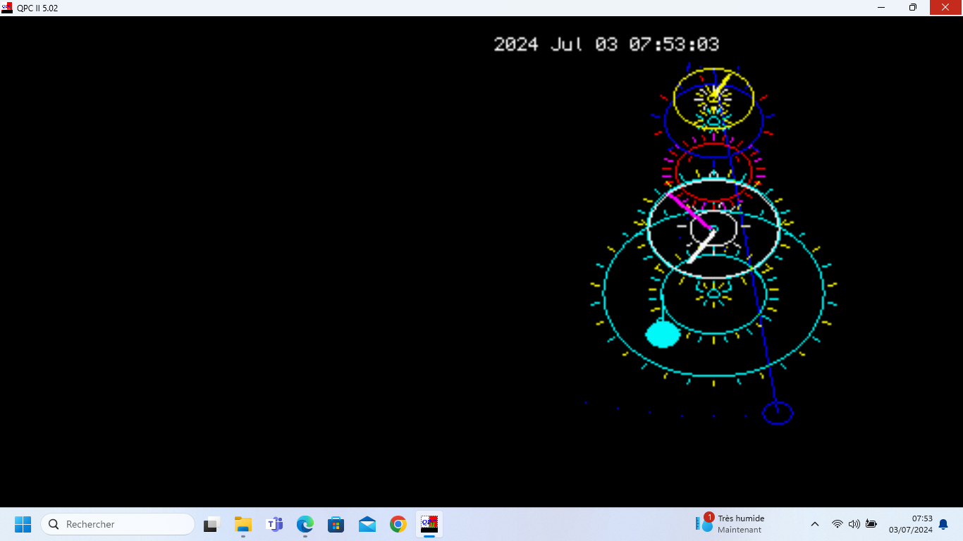

Re: Simple time-waster game
Hi Per and All,
Yes, I tried simulating a real mechanical clock mechanism, as you suggested, (but without a moon phase dial based on DATE).
It proved to be impossible to get the timing right, except by hooking it onto the QPC2 DATE$ function, (even using 'wait' FOR loops ! )
The problem is due to multicore multitasking going on in the background. It adjusts best with the slow/fast 'Fc' variable, line 670.
And, don't move your mouse off screen ! To avoid clutter, I simplified the number of cog teeth for better animation.
Still, it would be more readily comprehensible with an 'exploded' view, (requiring innumerable ellipical trigonometry calculations.)
As it is, code is compact thanks to Turtle Graphics. UNZIP, LRUN or ESCape, Regards, Steve.

- Aurora
- Posts: 903
Hi Folks,
Here's a screen shot of the 'Clocks_bas' program running.... Regards, Steve.
