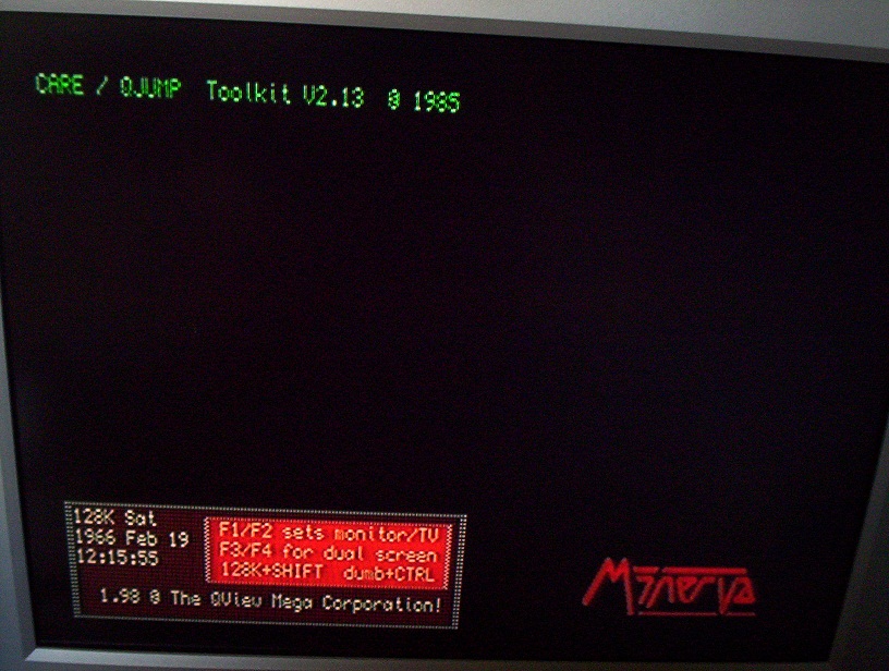

ppe wrote:Do you see the TKII ROM banner on the boot screen? TK version should be displayed in green text if the ROM image is read correctly.
Best regards,
Petri
No, the QJump TKII ROM banner, never showed up.

chriskgnr wrote:I programmed the eprom with the joined 48K+16K single file and then i programmed the eprom in two steps, first the upper part with the 16K(TKII) and then the lower 48K part with the firmware. But again no light in the tunnel!
Any ideas?
Have you checked that the file you created has the correct hex code at the correct offset? And if you then peek the memory at the external ROM module address, do you see the correct contents?
External ROM images should begin with the hex codes 4AFB so if you do a PRINT PEEK_W(49152) you should get 19195. If you don't, then at least two possibilities come to mind:
- incorrect EPROM contents either due to incorrect source file or bad burn
- incorrect/faulty wiring for address decode
chriskgnr
Brittle Membrane
Posts: 117
Location: Piraeus, Greece
Re: Sinclair QL Greek rom burn.
Post by chriskgnr »
ppe wrote:Have you checked that the file you created has the correct hex code at the correct offset? And if you then peek the memory at the external ROM module address, do you see the correct contents?
You are right! The 4A FB hex codes was not found at C0 00 address of the joined source file, but at BE B5 address. This happened because the Minerva rom image i downloaded isn't 48K exactly, but 47.6K. I have opened now the min198.rom with a hex editor program and i will fill with 00 until the BFFF address to make it 48K. That way, when i will join the TKII code, the Toolkit will start from C000 address. I think that now evrything will go well! :)

Yes, it worked! :D
and i want to thank all of you, for your help! :D

I have a similar problem with Chris. I made an EPROM with Minerva and TKII but on the boot screen wjile the Minerva logo is there I don't see the Qjump logo.
I checked and I do have the 4AFB at C000, the wiring of the pcb is correct but when I Type PRINT PEEK_W(49152) instead of getting 19195 I am getting 3855 (Hex F0F).
Any ideas will be greatly appreciated .
