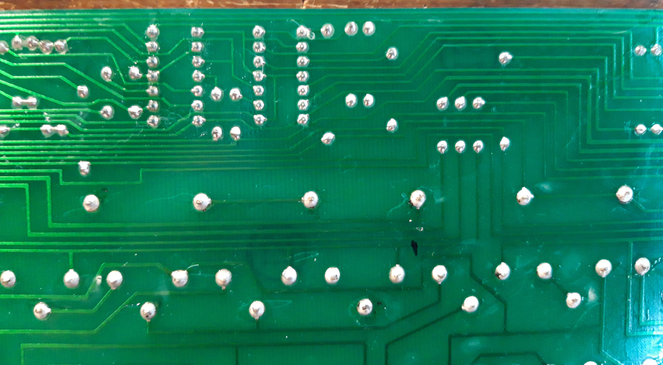

Don't think I can send pics in PM. Is the right area you needed to see? That electrolytic is in parallel with the diode next to it.
Re: Spem QL keyboard
Thanks.

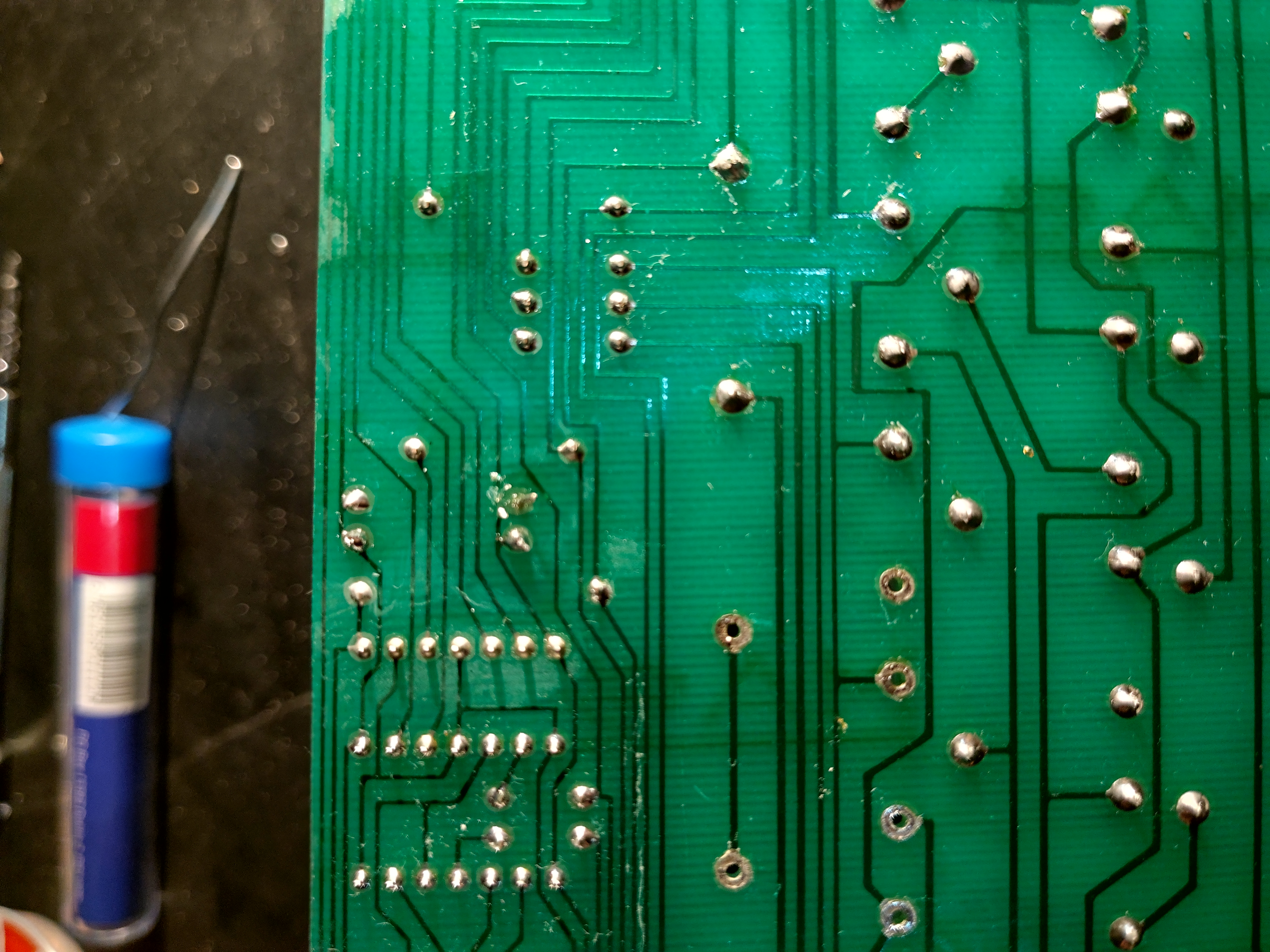

Does the diode or the capacitor leg touch the trace above it?
I have attached a picture of mine.
- Posts: 1393
Both the diode and cap leg touch the trace above.

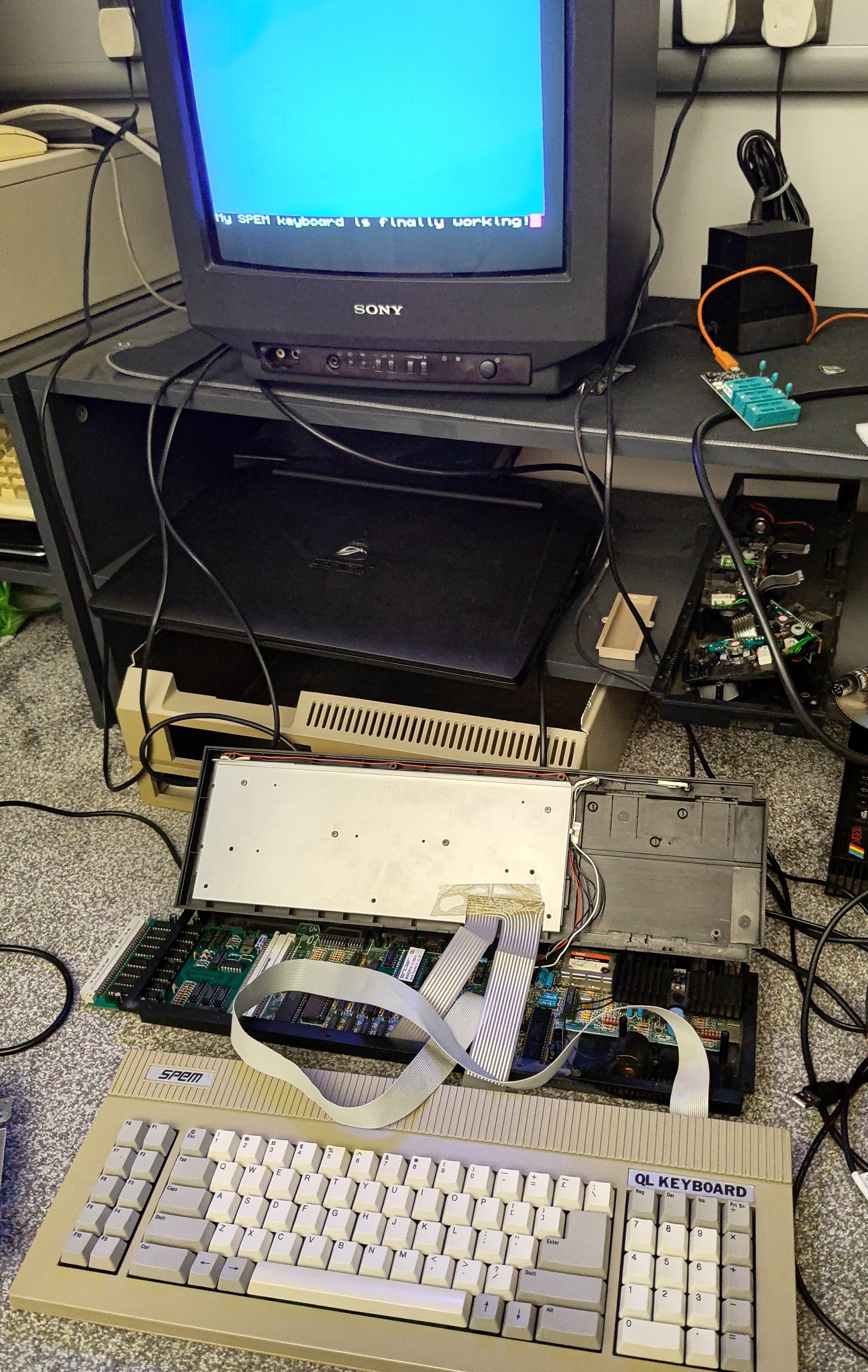

Chr$ - I believe you were correct regarding the keyswitches!
After removing the switches that were clearly malfunctioning, I was able to get all the keys working by making a triangular contact between the keyswitch points.
I have managed to order the Futaba key switches via my nephew who lives in Germany. Once they arrive, I will swap them all.

I think they're plastic welded together with round welds in each corner. You can get them apart and probably also re-glue them back together, but the actual switch part is below a membrane which is also stuck down and can't really be removed without damaging it. You can try to put some contact cleaner around the plunger so that it soaks down. That might make some work but really all you can do is replace them.Delta wrote: Mon Apr 10, 2023 11:53 am Chr$ - I believe you were correct regarding the keyswitches!

After receiving the keyswitches and removing the old to be replaced by the new, I am delighted to announce that my keyboard is finally working!
Thank you to all those who helped in particular Chr$!
I now need to work on a way to transplant the inards of my QL into a larger case so the keyboard can be connected in a more elegant way!
