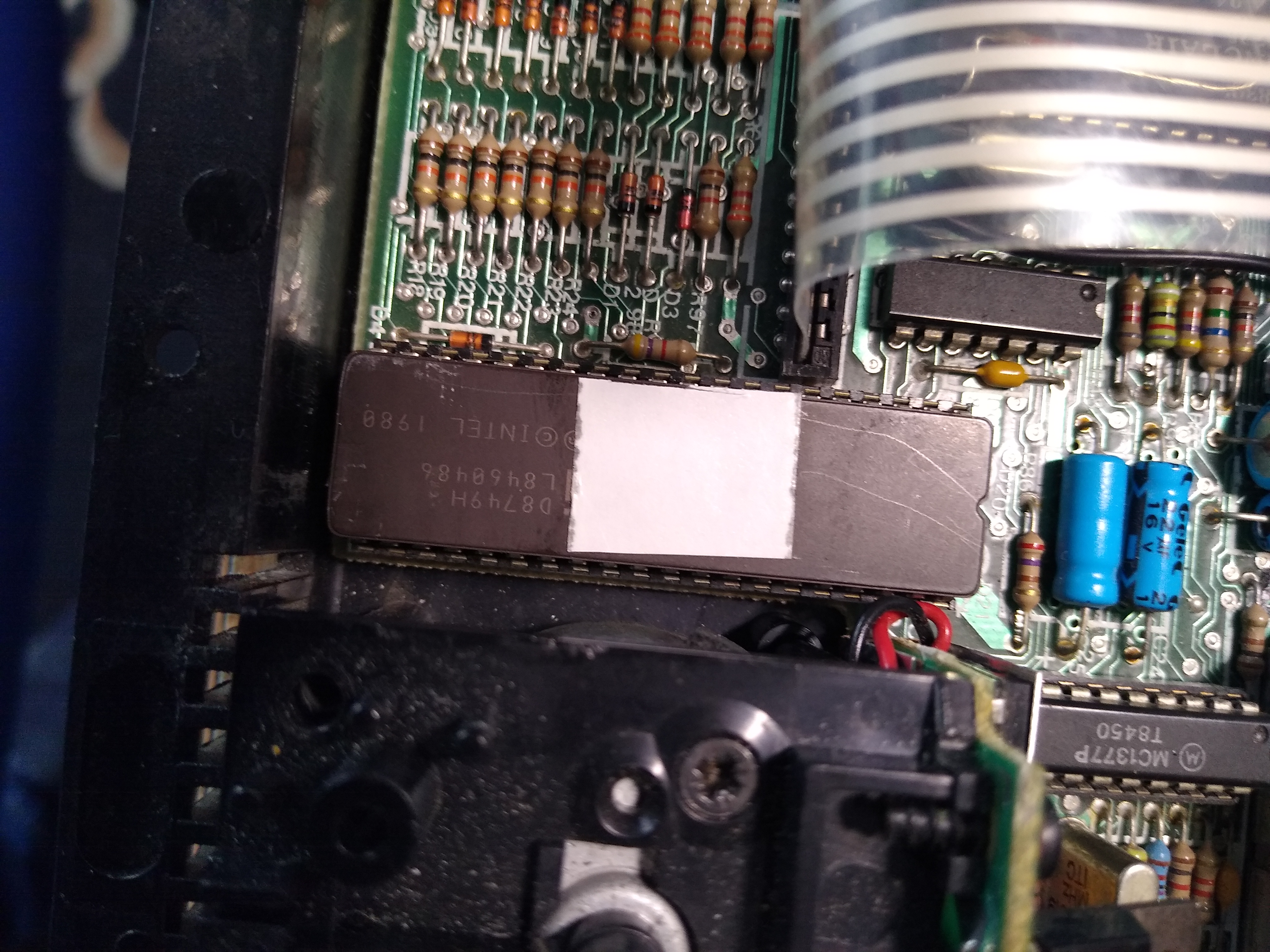

As I mentioned earler, I bought 10 Intel D8749H IPCs, only 2 out of 10 were abled to be programmed with the ALL03A programmer with the Hetmes code, after erasing them in a UV Eraser.
Here is one of the D8749H IPC in a Issue 7 QL: I usually put a better label over the UV Window....
I got a refund on the 8 chips, and they did not want them back, so I could see if there is a probl yhr chips or thr ALL03A programmer.
I will have build a HVEprom programmer as well.
