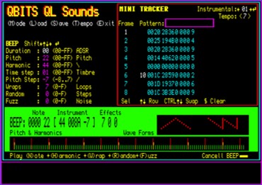

QBITS QLSounds_v4
I’m in the process of adding a TRAKER Mode to the BEEP and SCORE Sheet, I’ve loaded a mock-up of the screen in TRACKER Mode.
The core is the BEEP attributes as single channel (Instrumental) / row entry. Multiple Channels ???
At present the rows can be scrolled between 0 and 23. This can be expanded later.
Each Pattern is selected as a Frame, I’ve set 8 which again could be extended.
‘$’ Clears a row to all zeros. CTRL UP Down Cursors Swaps current row with one above or below.
In addition to the BEEP attributes, I have included a variable Tempo. This can vary the release time between rows, giving the effect of changing the speed of play back.
