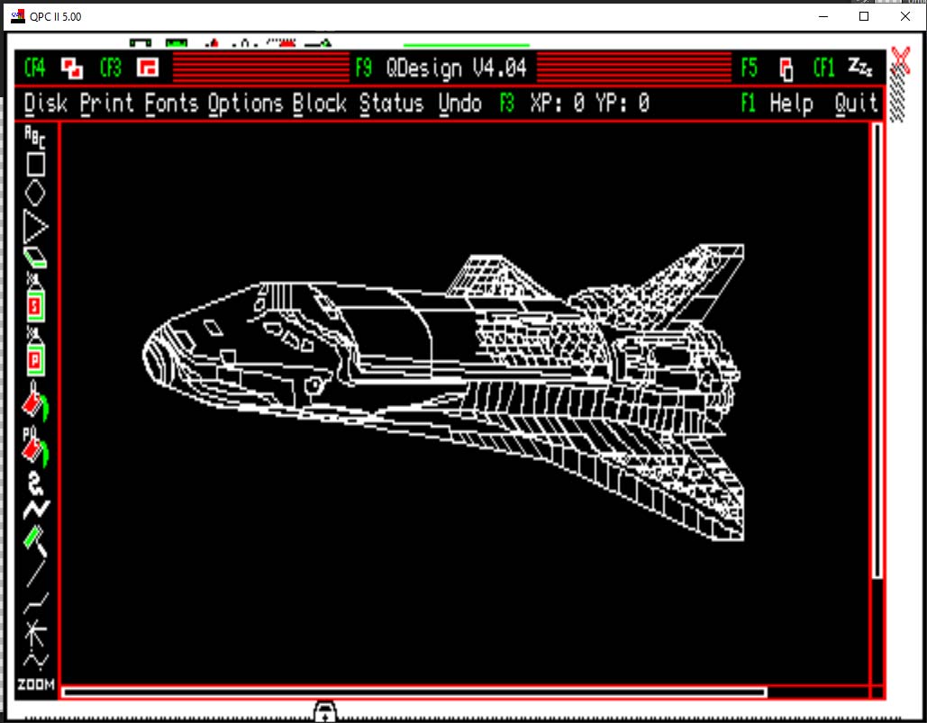

Has anyone managed to execute the 'QDesign' file in the BOOT file yet ? (using QPC2).
I get as far as line 65, where I get a 'bad parameter' signalled, but can't find a workaround !

Hi Again,
Great Per ! as you have Qemulator...
On QPC, I set screen resolution to 512x256, and :
16 scr=SCR_BASE
23 SCRB=128
26 Set the underscore to dot
65 Set to EX 'QDesign_bas' , after changing the filename.
This time, I get eight tiny screens across the top (of mine), and the program stops....
It looks like the program will need a lot of tweaks to work under QPC2 v4.02
I will report back after some head-scratching, but I fear little can be achieved without the source code !
Steve.

Re: Graphics program for SMSQ/E
Works great, both QEmulator and QPC2 (except for Help, which shows only a blank page, same as in version 4.02)stevepoole wrote:Hi Again,
16 scr=SCR_BASE
23 SCRB=128
Steve.
_____________
It needs to be configured with the proper directory names.
In QPC2 - I use 512x256 resolution, QL colours
Remark - version 4.02 works only with menu_rext version 7.66, but would not work with the newer versions. I have not checked this for v4.04
I tried to get 4.04 to work in QPC2 in mode 32 with QPC_QLSCREMU 4 in full HD resolution, but no luck. Some things work, others dont. Mostly they dont.
If the source code were available I guess it wouldnt be impossible to fix. It appears to me that the author uses mostly clean code. But he doesnt only use EasyPtr's ptrmen_cde, but some of his own toolkits, so it wont be enough just to unscramble the BASIC; the toolkits would need to be extracted, and possibly dissembled, too. Quite a job. Right up there with Qlib, I reckon, but not as useful by half.
Nice as it is, but without live source code, unless someone is willing to apply considerable elbow grease to the project, QDesign should be consigned to the relics. (IMHO)
No, the program is quite aware of the real screen base, so QLSCREMU will not work. As you say it is quite clean, uses XTOP when needed etc. It seems to be prepared for Atari screen modes but predates high colour modes by a bit.pjw wrote:I tried to get 4.04 to work in QPC2 in mode 32 with QPC_QLSCREMU 4 in full HD resolution, but no luck. Some things work, others dont. Mostly they dont.
The extension thing is easier than QLib I think, no idea about the basic part. I could imagine myself doing it for the fun of it (the extension part). These are the extensions involved:If the source code were available I guess it wouldnt be impossible to fix. It appears to me that the author uses mostly clean code. But he doesnt only use EasyPtr's ptrmen_cde, but some of his own toolkits, so it wont be enough just to unscramble the BASIC; the toolkits would need to be extracted, and possibly dissembled, too. Quite a job. Right up there with Qlib, I reckon, but not as useful by half.

It's ready to run in my QPCDemo, available on my site... right-click Start and select QDesign. Remember to start in QL mode.stevepoole wrote: Has anyone managed to execute the 'QDesign' file in the BOOT file yet ? (using QPC2).
