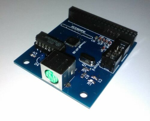

Yup, I didn't think a straight out USB implementation that allowed for any device as I figured that would be complex. I guess it might go the route of say the RetroWifi (which I have and haven't played with much yet) which itself is a computer on a chip implementing all of the networking protocols the unexpanded (err BB) QL could never do on its own. I remember before I found that I was thinking you could likely do that sort of networking on a QL if you used a Raspberry Pi and connect via serial port so that isn't too far from that. I was initially thinking more PS/2 since I see that being done on other retro platforms (the Spectrum Next comes to mind).
So I was just curious if anyone had tried to create a PS/2 ROM-socket'ed device for the QL and how difficult it would be to do. I saw this for Spectrum clones but I think it connects into their keyboard socket directly, which I assume makes that a ton easier, as there is no modification to the ROM to map keyboard entries. Now could this be used as a starter, by initially re-mapping Speccy to QL keys to see if you could get it to somewhat work...dunno. Wish I had grabbed that odd QL motherboard that was inexpensive so I had it to play with as I don't want to tear apart the only one I have to try with.
Addendum: ...and I found some designs that works directly with a Spectrum:
http://trastero.speccy.org/cosas/droy/imar3/imar3_e.htm
http://www.jrok.com/project/speckey/spec_key.html
