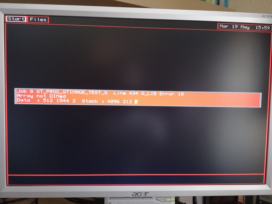

Hello.
Since I updated SMSQ/E 3.36 version in my Q68, I've had a problem with QTImage (from Quantum Technology). The error is "Q_LIB error 18". That problem doesn't happen with SMSQ/E 3.32 version (for example).
Am I doing something wrong or do I need to update some libraries? Any ideas?
One image of the error is the following:

No idea, could be SMSQ/E or could be a coincidence. You could try the versions in-between to maybe narrow it down to a specific version if it is indeed a problem in SMSQ/E.

Hi, which version of QTImage are you using?

mk79 wrote:No idea, could be SMSQ/E or could be a coincidence. You could try the versions in-between to maybe narrow it down to a specific version if it is indeed a problem in SMSQ/E.
OK, I'll try the intermediate versions.
Giorgio Garabello wrote:Hi, which version of QTImage are you using?
I'm using version 1.4. By the way, should QTImage work on a QL with SGC?

I use it with the 336mod (on QPC2) and it works well.
work with SGC with Aurora

Giorgio Garabello wrote:I use it with the 336mod (on QPC2) and it works well.
OK, so I must have something strange in my system. In my QPC2 system with SMSQ/e 3.36 I have an error with QTImage. I have to find out what's wrong with my system.
Giorgio Garabello wrote:work with SGC with Aurora
Thanks for the answer. (QTImage is a nice development).

I've checked again this problem in my systems.
This problem with QTimage only happens with SMSQ/E version 3.36 for Q68.
(QTImage In Q68, with SMSQ/E 3.35 or earlier versions all work fine. In QPC2, all versions of SMSQ/E, QTimage work correctly).

Problem identified with the help of Derek (and Giorgio).
Now I have my SMSQE 3.36 with Q68 system working with QTImage.
The problem was that I had defined language 34 (Spanish language, ES) in the SMSQE configuration (Q68_SMSQ config). That is new in SMSQ/E 3.36 version. With that configuration QTImage fails. I have now switched to language 44 and QTImage works correctly. My problem is solved because in my boot I activate the Spanish keyboard template with KBD_TABLE 34 command and everything works fine (QTImage works without problem with Spanish keyboard layout).
