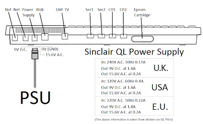

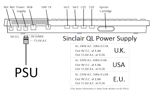

So the power supply gives two different voltages (picture attached). You can get either internal SD card(s) reader to replace the microdrives or an external one that doesn't require any mods (vDrive). I have the latter an it works pretty well. The internal SD reader is likely faster but I think takes up some free memory and maybe uses the external ROM slot (though doesn't plug into it so internally) ... not totally sure since I don't have one.
