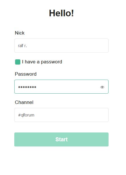

Even that does not work:

Yes, user nicknames cannot have a space. Keeping it to alphanumerics only is safest.
Missing left bracket between CHR$ and 13 causes the syntax error - my keyboard keeps dropping random characters as I type from time to time (bad workman blames his tools!)
