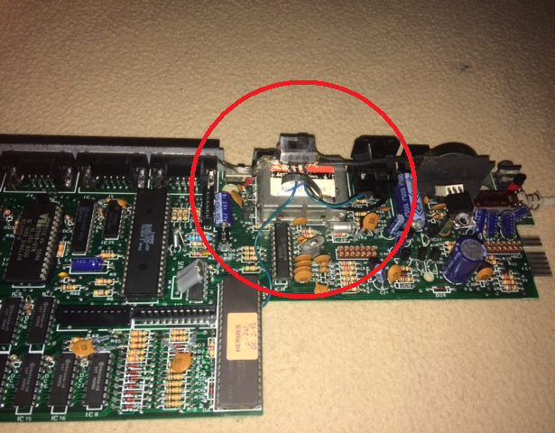

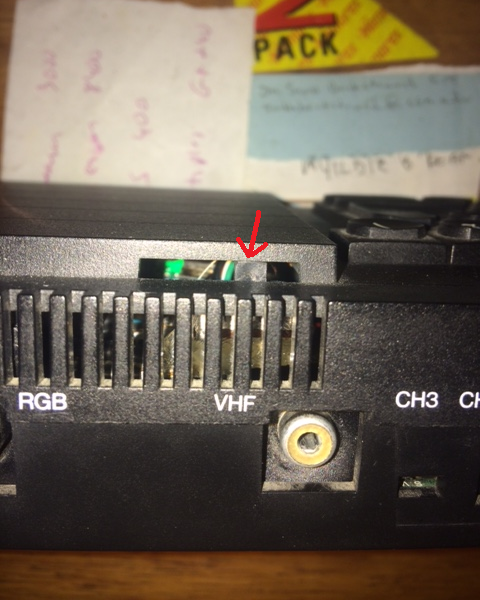

So I finally did the mod. What I discovered is that color composite is indeed NTSC. What gets confusing is when I use color composite and press F1 for monitor my cheap monitor can't handle the signal, gives me a crappy monochrome picture and says PAL. So Martin was correct, the monitor was just getting confused.

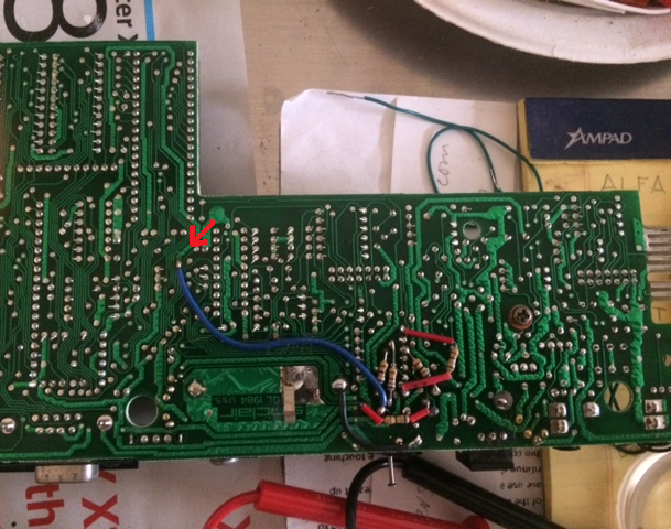

Looking at the back of the motherboard the blue wire goes right to pin 1 where it connect to the motherboard (pal color composite -- or in my case NTSC color composite). When I unsoldered the blue wire on the top end and took a multimeter, it was still seeing connections so it must be on the other side of the motherboard under the RGB connector. I then decided to see if pin 9 on MC1377 was connected to pin 1 of RGB and indeed it was. So then I just tried to see if I could finally get a picture. I got no picture anywhere. Looks like that blue wire supplies the 5 volts for the video and just gives a high to pin 1. I have no idea.
In any case, there was no way I could get to pin 1 of the RGB connector and somehow cut it to bypass it to pin 9 of the MC1377. The only pin on the RGB connector that seems to be isolated was pin 3 (the monochrome composite) which is likely why it's such a crisp picture since it's not connected to all the other pins (btw, when I say they are all interconnected, there is resistance on those lines but they do let signals through...it's like 5-10K ohms).

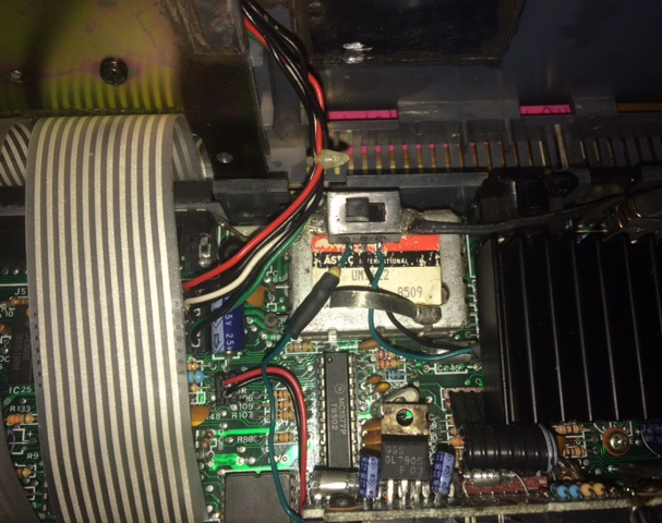

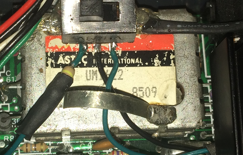

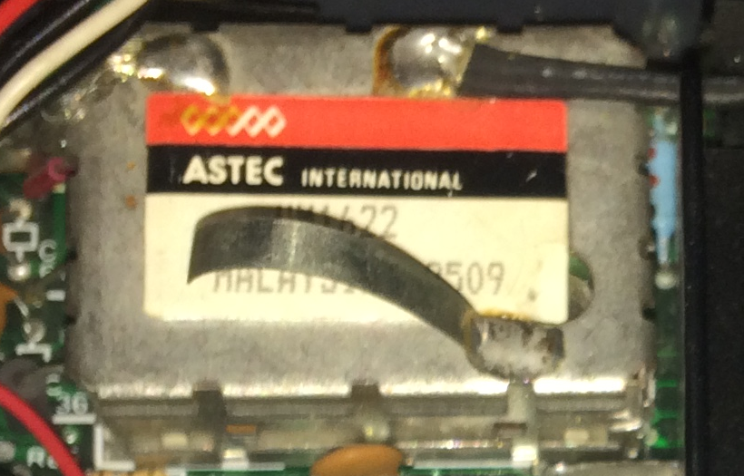

Pin 3 is connected to a trace that goes to a resistor. I pulled the one end of the resistor and put a 2-way switch that bridges either the resistor to pin 3 or mc1377's pin 9 to pin 3. I placed it with a glue stick on the modulator as it was a perfect place to access it near the vent in the back (I didn't want to cut the case and I like to mod things that are completely reversible).
After I got it all back together the picture was a bit washed out color wise. So I followed Adrian Black's advice and stuck a 47 ohm resistor on in and it actually improved it a ton...now it's as good as the RF.
This turns out to be better than getting pin 1 working because this way I only need one DIN-8-to-composite cable that can show both monochrome or color by flipping a switch.

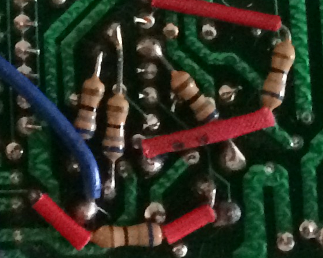

All those resistors tacked onto the board under the video socket is not normal on a UK QL. It may be that a previous owner has tried to reduce the 5 volt RGB signals to 1 volt signals. Which are required by some monitors or TV's. This is usually done by a couple of resistors in each line in a QL RGB to SCART cable ( I don't know if SCART was used in the US).
I think that black wire may be normal. As for the zener diodes, I have never tried using them. Although I did once patch a TTL logic chip into the signal lines to act as sacrificial buffer. I think the main thing, is to never plug or unplug the DIN video connector when the QL or the monitor are switched on.

Martin_Head wrote:All those resistors tacked onto the board under the video socket is not normal on a UK QL. It may be that a previous owner has tried to reduce the 5 volt RGB signals to 1 volt signals. Which are required by some monitors or TV's. This is usually done by a couple of resistors in each line in a QL RGB to SCART cable ( I don't know if SCART was used in the US).
I wish I had actually looked when I had the motherboard off but I blew the picture up and it looks to me to be blue/silver/black/gold which is 68 ohms. The resistor at the bottom of the picture could have a brown instead of black band but I think it's just lighting since they are all likely the same. Plus, I have some spare resisters in the 100's and the brown band looks much lighter, esp compared to the gold band. You be the judge (if you click on the picture you get a much, much magnified picture).
From what I've read the resistors need to be higher (330 ohms for the color and 390 for the sync). Also, no traces cut just bridging so does that work? My US board looks a lot like the German boards. I have a capacitor on my 68008, I have diodes on the ZX8301 (btw,what do they do???) and a daughter-board on top of my RAM and I've definitely seen those mods on pictures of German QL's posted. So lots of mods. Plus the blue wire on back seems to supply a crucial voltage.
On the back it says "Sinclair QL US 5" so does that mean I have an issue 5 board US?
