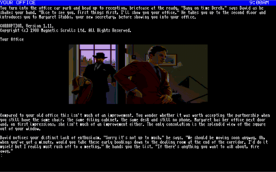

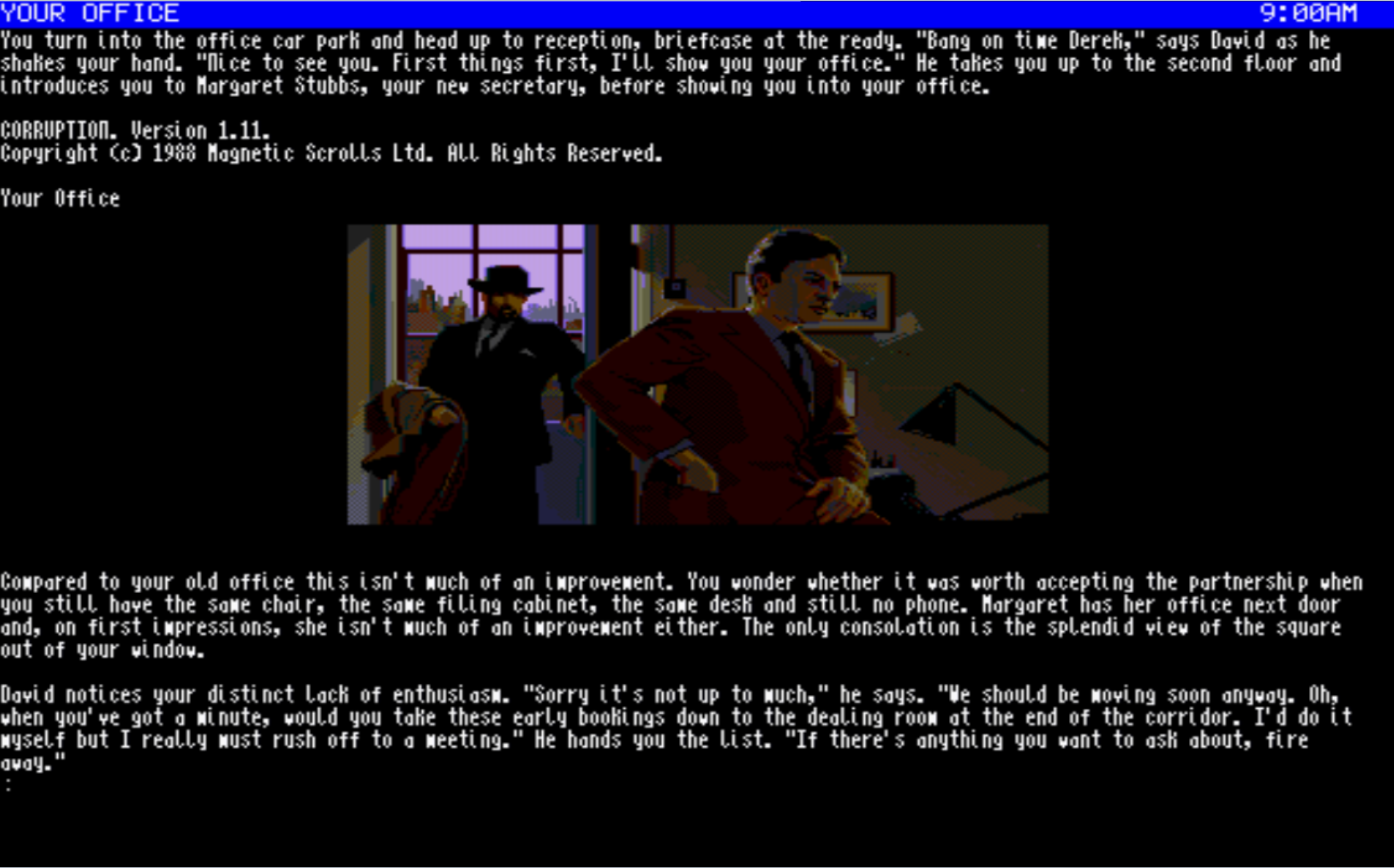

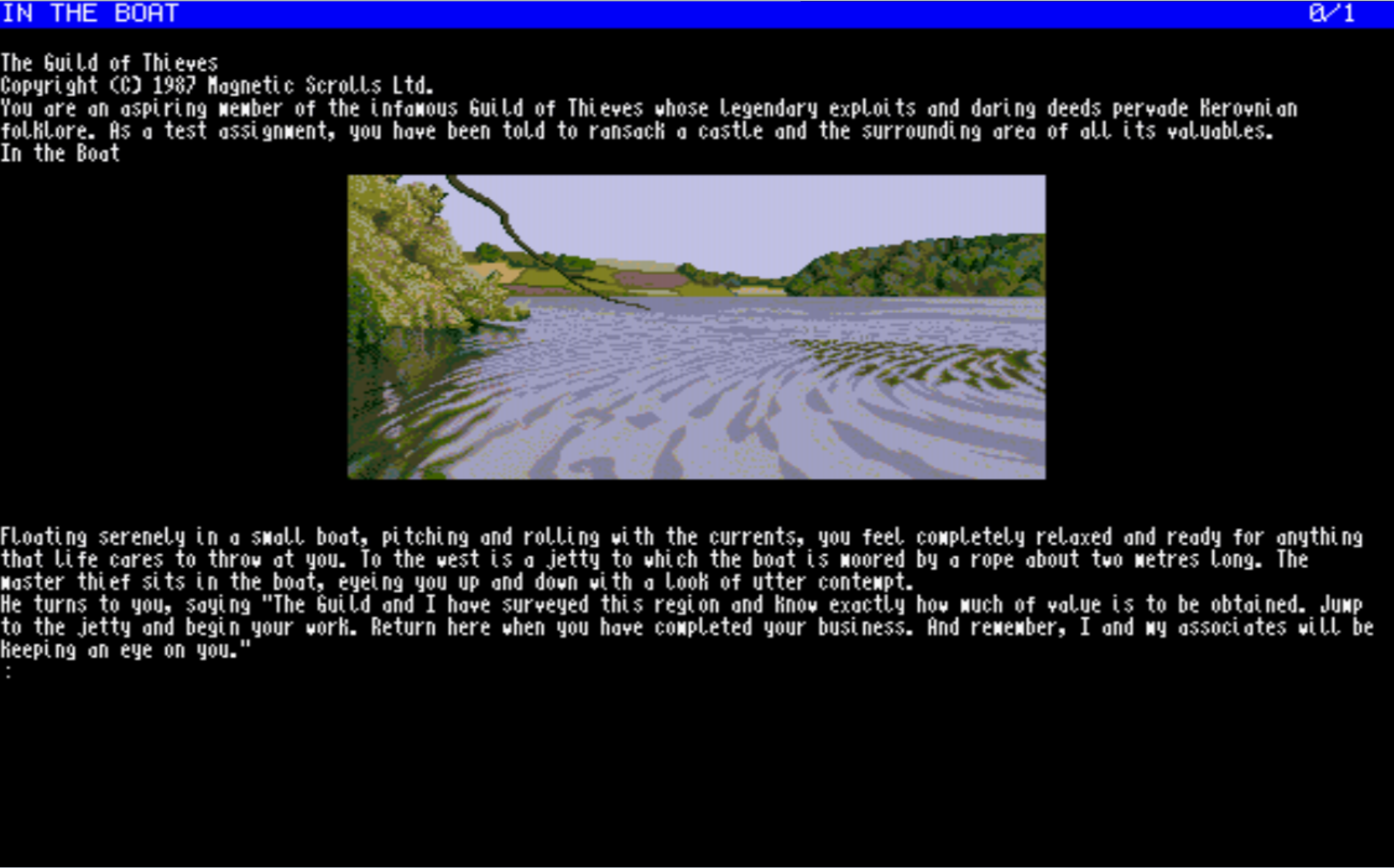

Two more teasers, especially for Mr. Parp!
