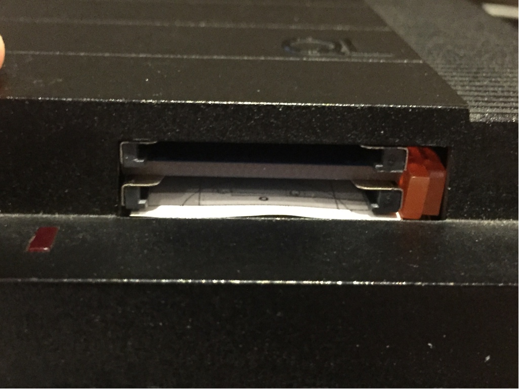

In other news, I think I finally have a design for the MDV daughter board I like, I will probably order the boards soon. But it's at least another 2 or 3 weeks until all the parts for it arrive, so I'm not quite in a hurry ;) I've attached a picture of the paper mock-up. The second slot is an optional feature.
I've soldered some 8 QL-SD boards or so so far. Despite the low part count it's quite time consuming, about 30 minutes per board IF they work on first try, usually more. I've ordered a metal stencil and will try my luck with reflow soldering next.
I've also put a lot of time into the driver and I'm very satisfied with the result, yesterday for example I implemented automatic detection of card changes, this makes transferring data using QL-SD very very comfortable :D
So things are still moving along. Cheers, Marcel
