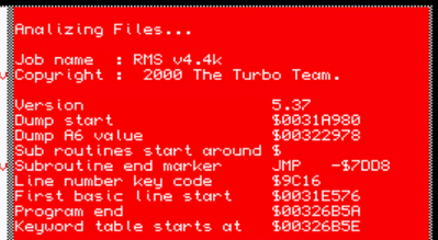

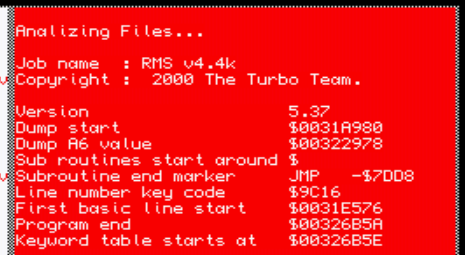

My first attempt at running (Turbo)ProcessDump against one of my Turbo compiled apps failed to recognise my version of Turbo (appears to be v5.37).
I naively modded the SELect ON version clause for 5.1 to accept 5.37. The program then runs without error, but produces an empty _codes file and displays an empty value for the "Sub routines start around" field (the rest of the summary looks reasonable):
Not unexpected, given its early stage of development and the numerous versions of Turbo out there... :-)

OK, so after adding a SELect ON clause for version 5.37, thus:
ON version=5.37
  jmpkey$="4EEE8370"
  jmp$="JMP   -$7C90(a6)"
  lineStart$="3E1D" : REMark move.w (a5)+,d7
ProcessDump now populates the "Sub routines start around" field and also populates the _codes file. The output _lib file also has sub-routine sections split-out, so we're getting somewhere.
However, ALL the line-number references in the _codes file report as '-1', whereas I know that the job was compiled with line-numbers enabled, so still something amiss to work with Turbo v5.37.
I'll play some more tomorrow.
