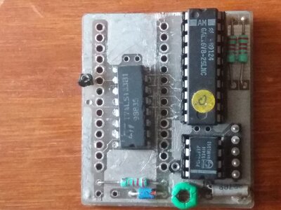

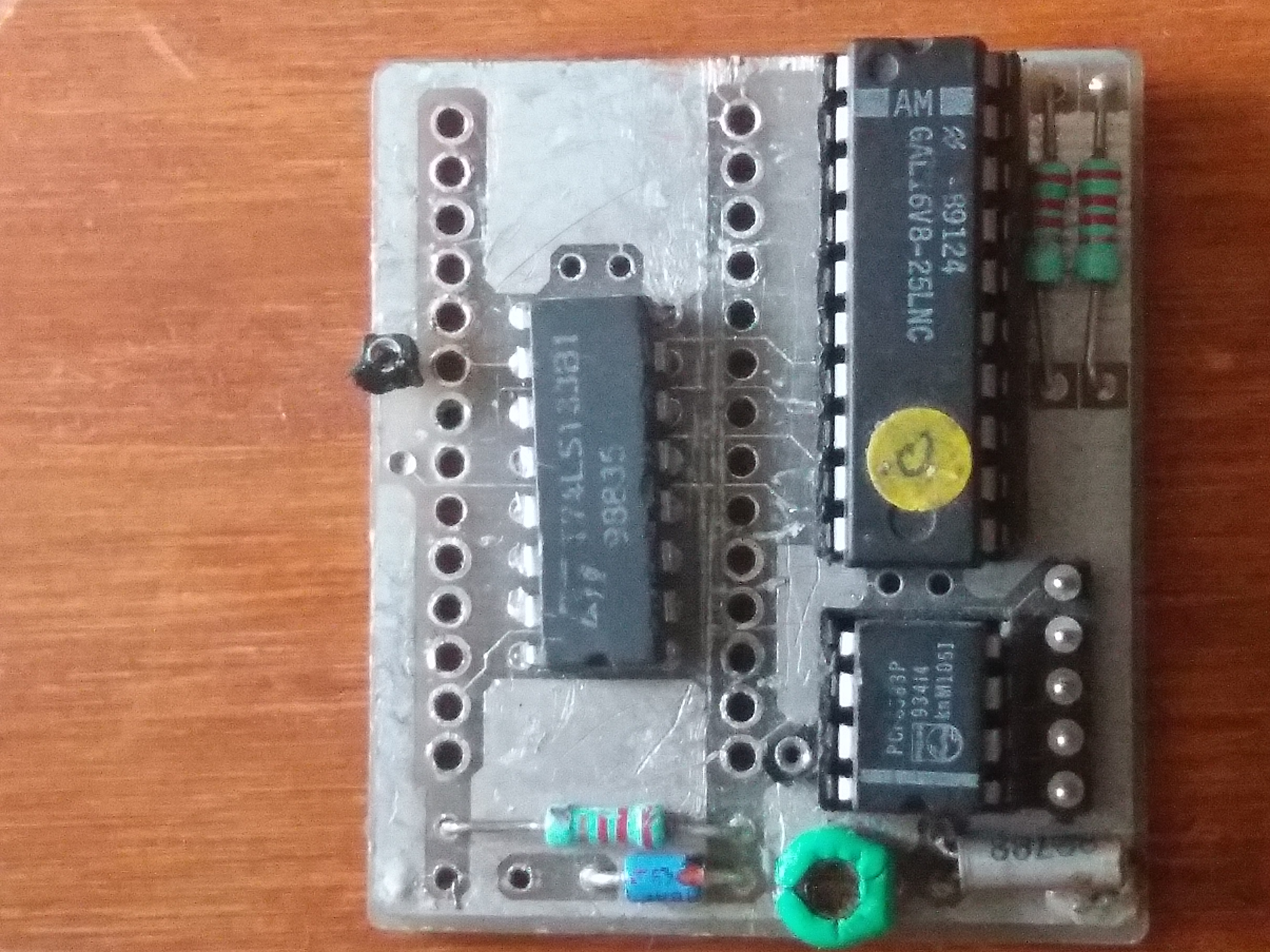

I'll take a photo of my (much hacked) Mk2 board and add some comments over the next few days before posting again.
Martyn.

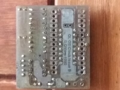

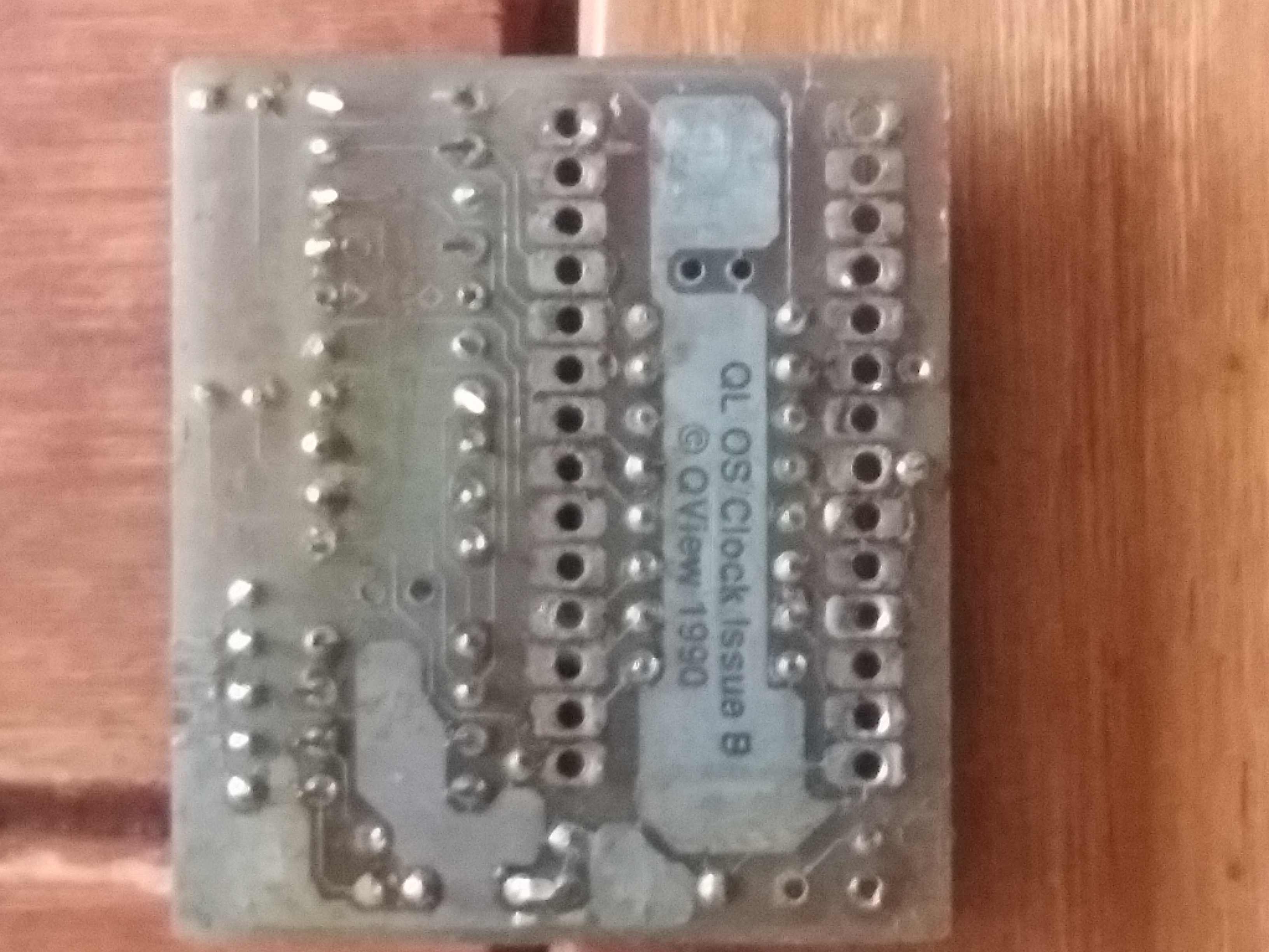

I have Minerva MkII that I was repairing broken pins on the Rom Socket.
But I decided to remove the complete Rom Socket and see if I could reverse engineer the PCB. As Tony Firshman sent all his Minerva Stuff into the Texas Black Hole...
Here are photos of the Minerva MkII PCB minus the ROM Socket.

so looking at those stripped circuit boards - the chip under the ROM was a 13 Input NAND gage - so presumably used to do the finer address decoding for the SDA / SCL of the I2C offering - the actual driving of those signals appears to be done in software within Minverva.
It might be handy to know which pins of the 74LS133 are connected to which address lines of the ROM socket, although the addresses within the ROM can be determined.
