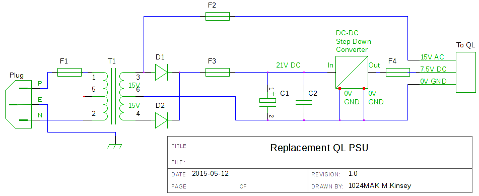

As I said above, you would need two transformers.
One with a 15V secondary - feed one wire to the QL via a fuse
The other wire connects to the 0V pin on the QL
The second transformer should have an output of 9V. This should then be full wave rectified. Then go to a simple "pre-regulator". Followed by a large electrolytic capacitor (smoothing) and then the output goes to the QL. Include a fuse.
The "pre-regulator" can be a power transistor (mounted on a heatsink) controlled by a resistor and Zener diode.
If you use a single 15V transformer and try to use this to feed the 9V DC supply, you will need a big transformer and an even bigger heatsink to get rid of the excessive voltage (power).
However you could use a "simple switcher" switch mode DC to DC converter to drop the rectified and smoothed 21V (that you would get from the 15V transformer) to 7.5V DC. See here for one of many available.

The one you linked to uses a LM2596 like the one I linked to. This chip does all the hard work, it is a switch mode regulator chip.
Up to you if you want a voltmeter. There are lots of these DC-DC converters on eBay. It does need to be a step down type though. Oh and remember to adjust the output before connecting to the QL!
I was thinking of a circuit like this:- Because we are feeding the output of the secondary of the transformer to the QL and the QL uses the DC 0V / GND line as a common for the 15V ac as well, you cannot use a four diode full bridge rectifier.
Mark
