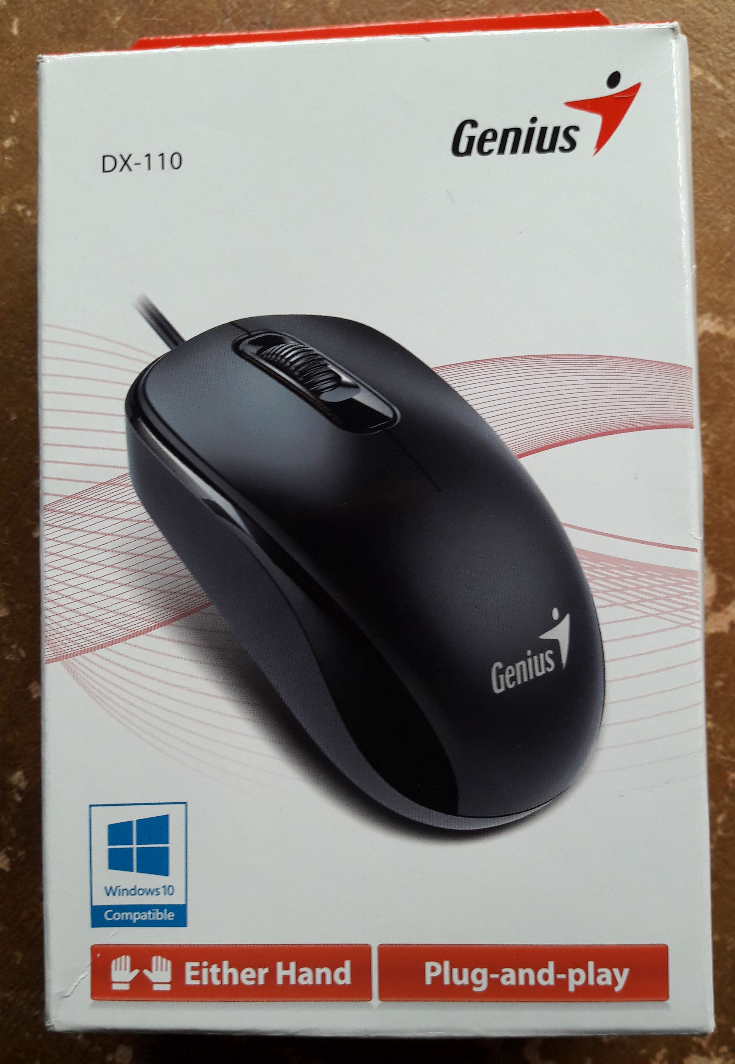

All's well that end's well - the new power supply arrived 10 minutes ago and my Q68 is now fully functional (I also got that keyboard that was mentioned). Hurrah! My USB to PS/2 mouse adapter does not work , so I've ordered a PS/2 mouse to complete the setup.

I have also found a PS2 mouse that will stop the Q68 boot after displaying the PC.CLOCK. Avoid, see belowPlease note that if the Keyboard is connected to the Green Mouse port of the Belkin PS/2 Splitter, then the Q68 will not boot at all, it stops on the Boot Screen after displaying the PC.CLOCK.
http://theqlforum.com/download/file.php? ... ew&id=1823
It was attached to the PS2 mouse socket and keyboard in keyboard socket.
Curiously an old and cheap optical USB mouse works perfectly with a USB to PS2 adapter.
