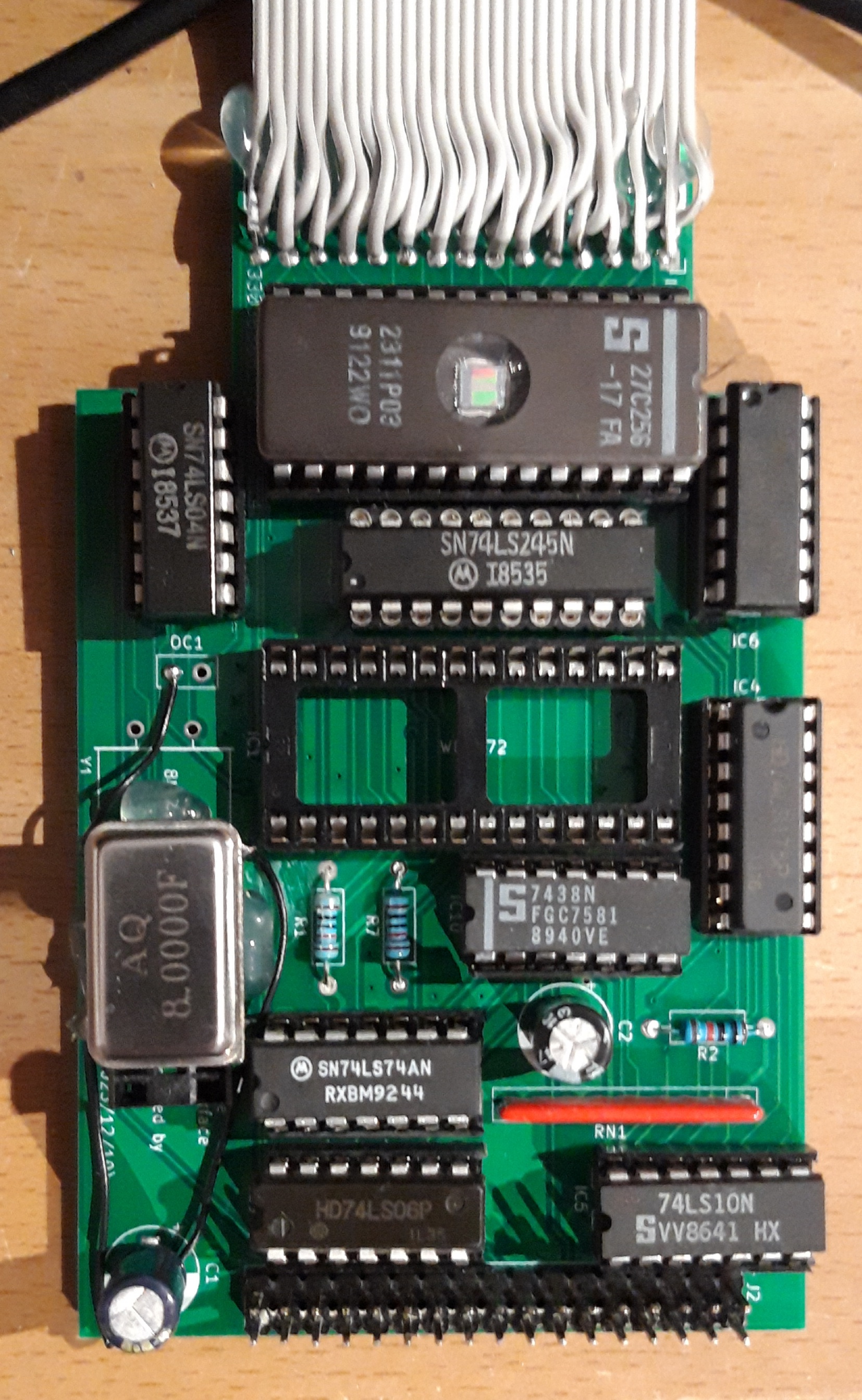

Re: ICL OPD
I made my interface card today, here it is:
viewtopic.php?t=4667
Before I even had a chance to test it I found that my working Merlin Tonto has quietly died in storage and now shows 3 vertical white stripes. Instead of cluttering this thread, here is a new one on that:viewtopic.php?t=4667

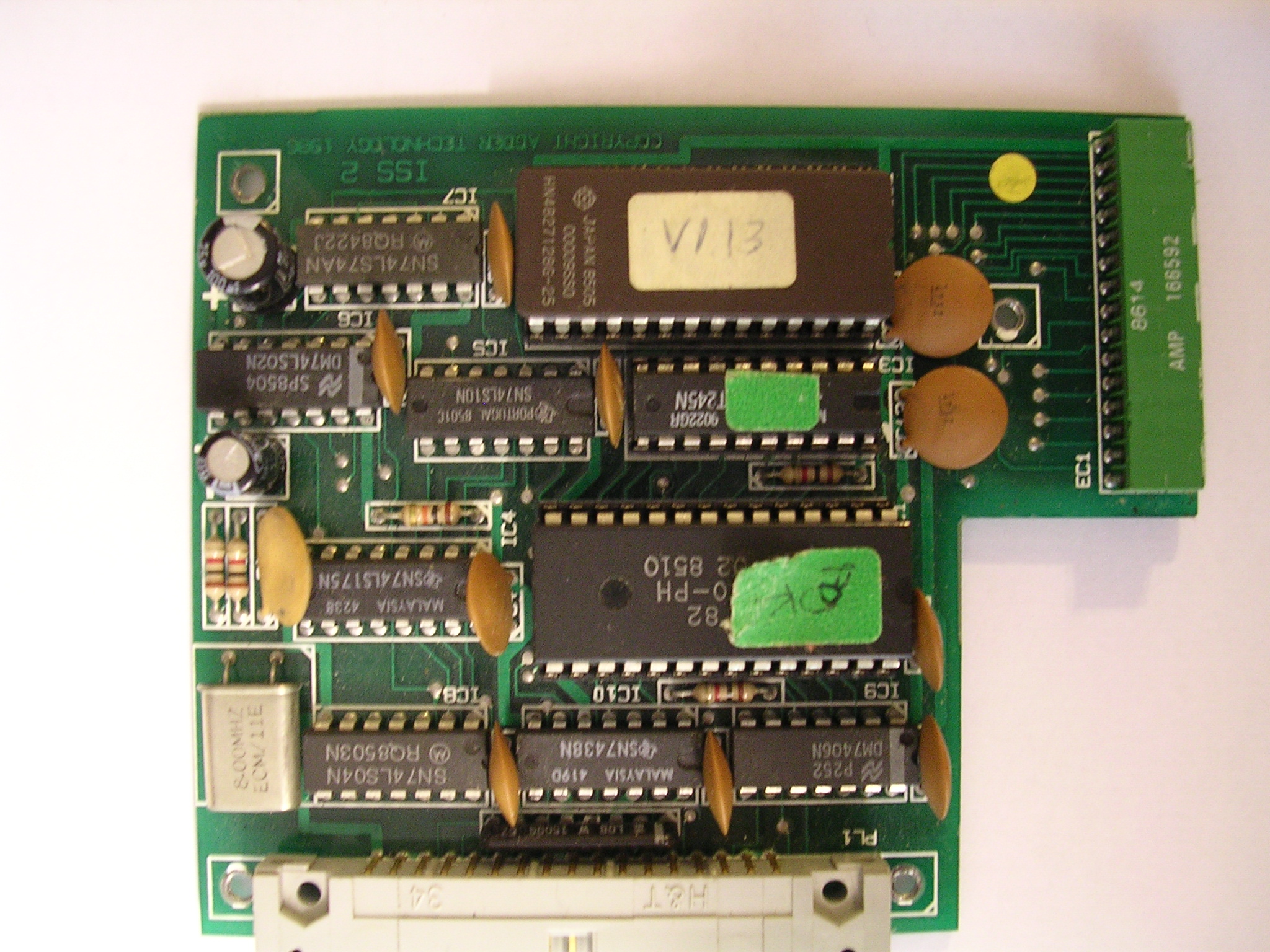

Re: ICL OPD
Looking at that pic I had again of the C1 disk controller and even though there is a sticker on the controller chip, I think it's a WD1770, not a WD1772 as they had a later (85) copyright date, not 82. Anyway, thought that might be of interest. Hopefully I'll have a working OPD soon to try it!

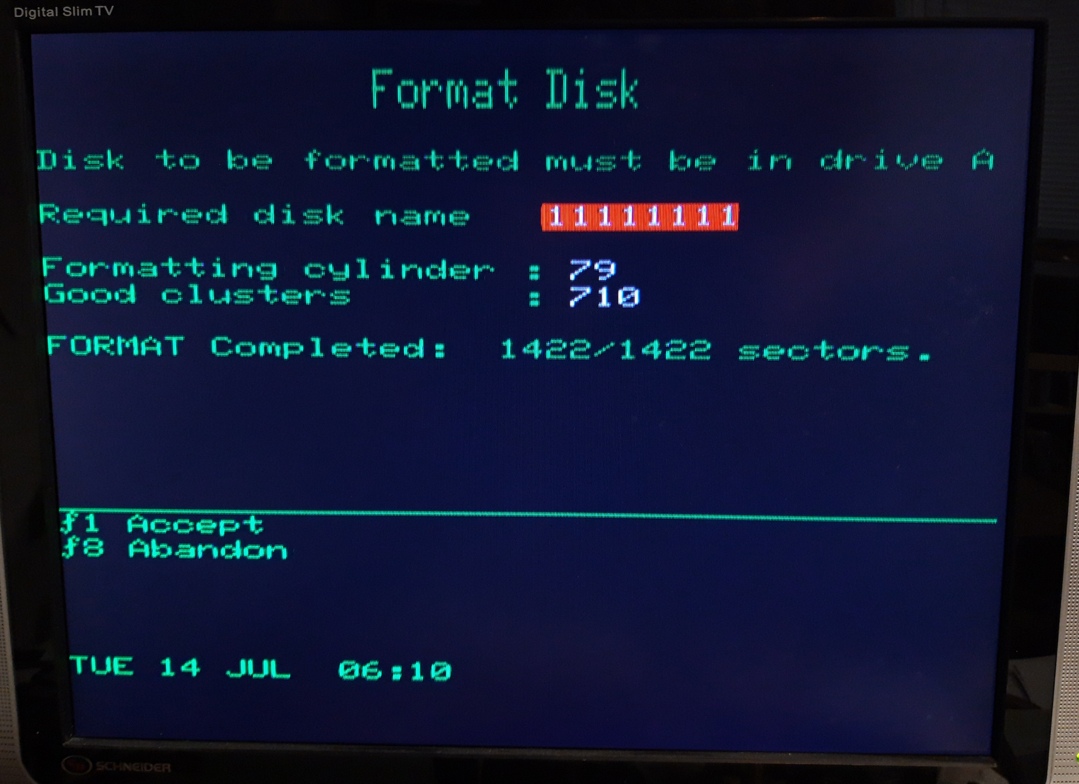

Re: ICL OPD
After some faffing today (dodgy FDD cable) I now have a working C1 clone floppy interface connected to my Merlin Tonto.
A couple of useful observations:
1. It seems to work just as well with the slightly cheaper WD1770-PH controller chip as it does with a WD1772 variant.
2. It also had no issue with a random 1.44mb drive I attached to it jumpered as DS0, formatting as drive A to the normal 720k.
I was able to copy all of the files from the ICL microdrive cartridge wallet (Basic, Demo, Welcome, Help) to a single floppy disk. Imagine how convenient that would have been in the day! What is of course not convenient is the way you have to copy each file manually, naming it from the source and giving it a name to become on the target. Absolute nightmare user interface, but that's by the by.
I did use the ROM version with MS-DOS compatibility but have not yet tried the disk in a DOS machine. Also not tried anything with Gotek and disk images etc yet.
Excellent work Stephen. I'll look forward to making an updated version whenever that comes.
