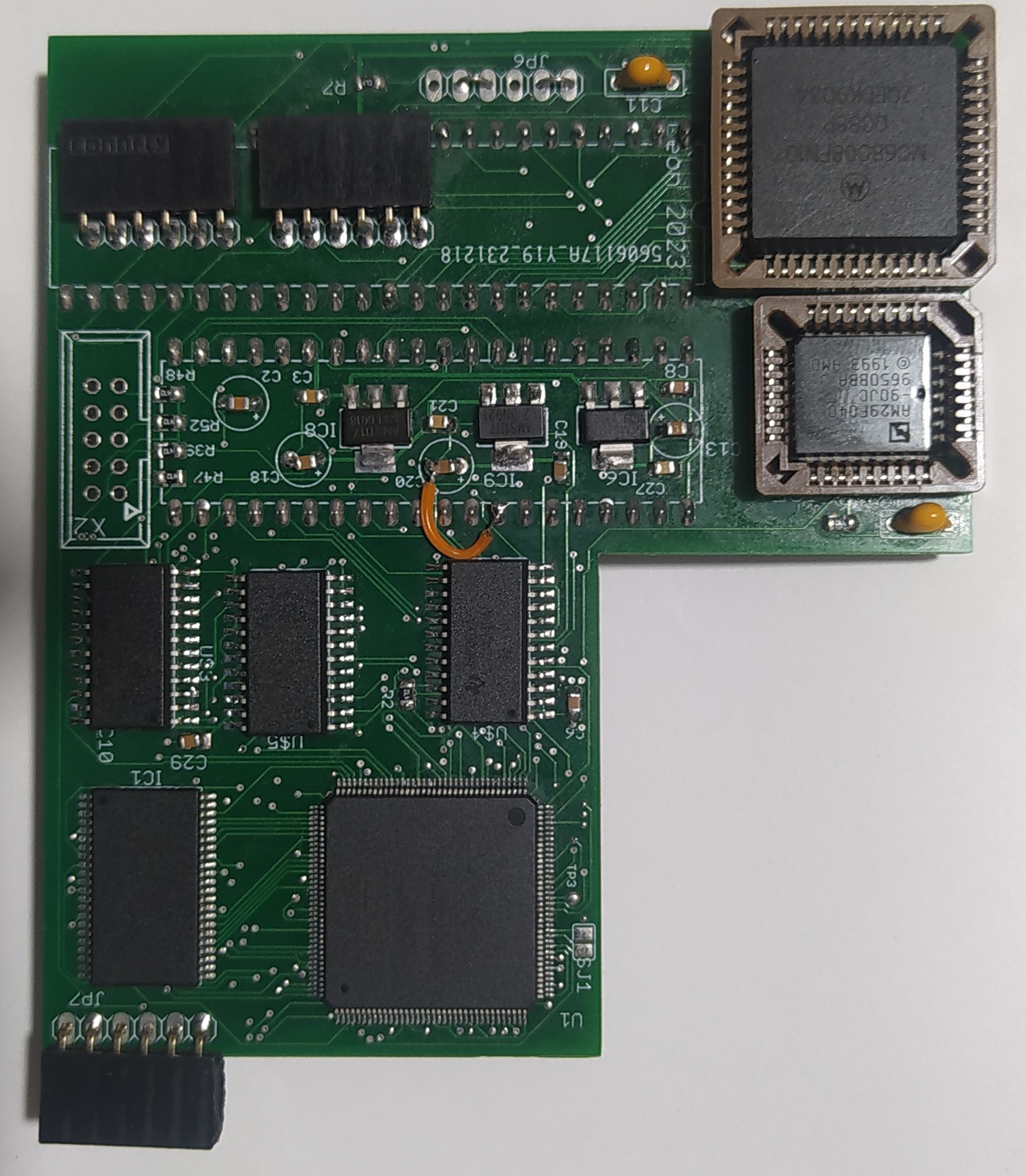

This is the latest version of the upgrade board and closer to a final (final lol)
Now it has 2 extra sound channels.
I'll try for a final with an even faster cpu, I hope it will work or else this is it with just a few error corrections.

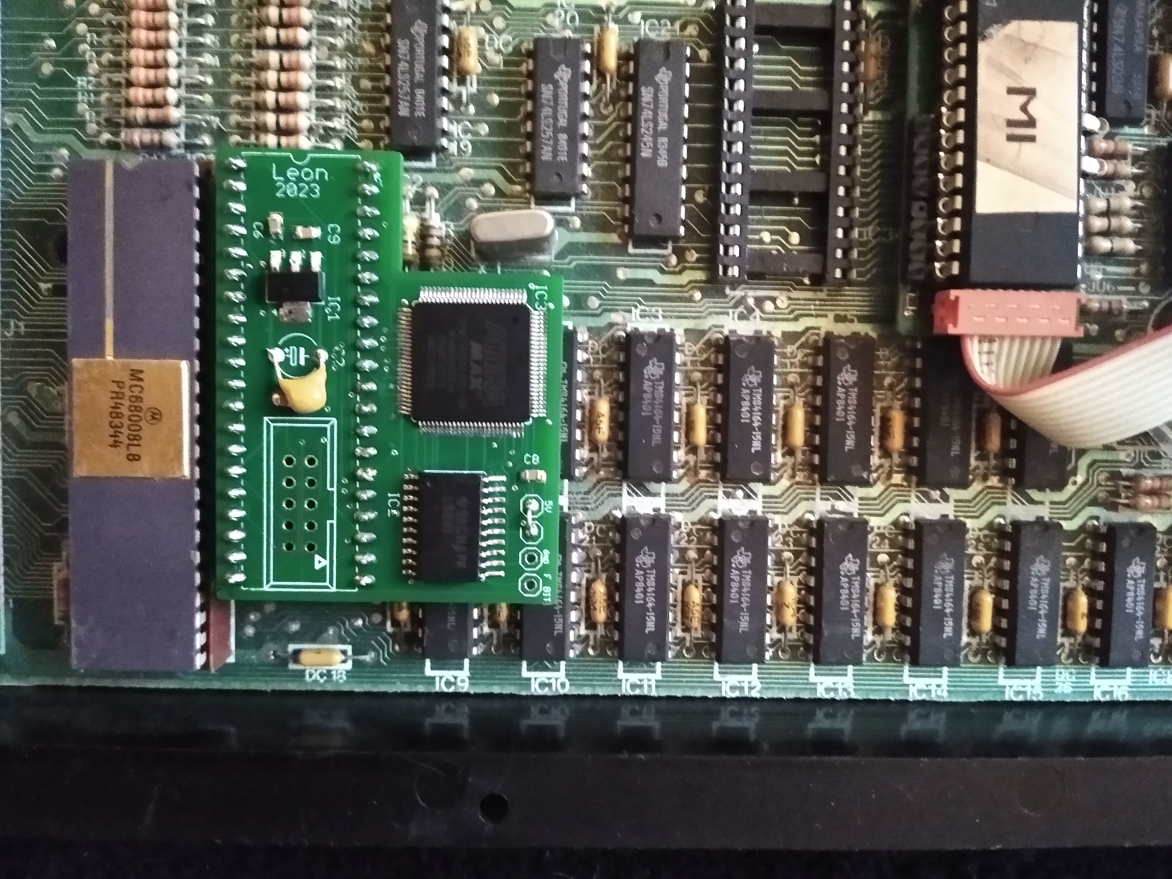

Hi Leon,
I have now received my ULA replacements, nicely soldered and packaged.
I like the more compact for factor. Thank you very much for all the work.

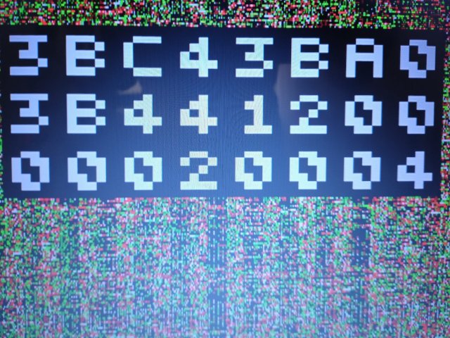

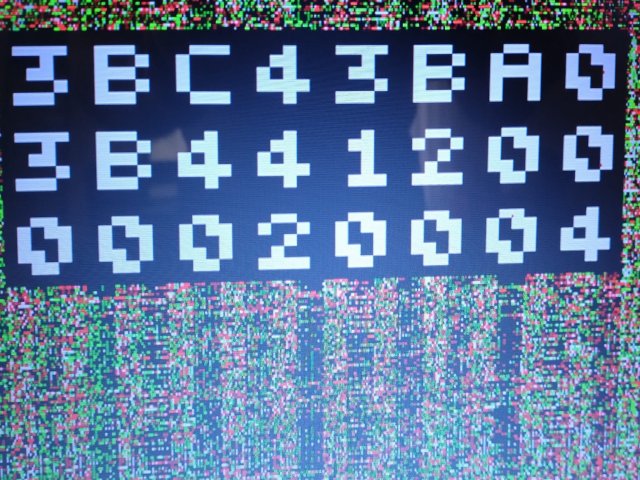

The video output is good, but unfortunately both units generate Minerva error messages: The fault is the same for both units, so it does not look like a soldering mistake.
I have checked the TQFP soldering under a magnifying glass, and it is perfect (great job!)
The fault also comes up if I add an external RAM extension.
I have re-seated the original ULA two times and the fault disappeared each time.
Any idea what's going wrong or what I could test without re-programming the CPLD?

This definitly sounds like a faulty socket?

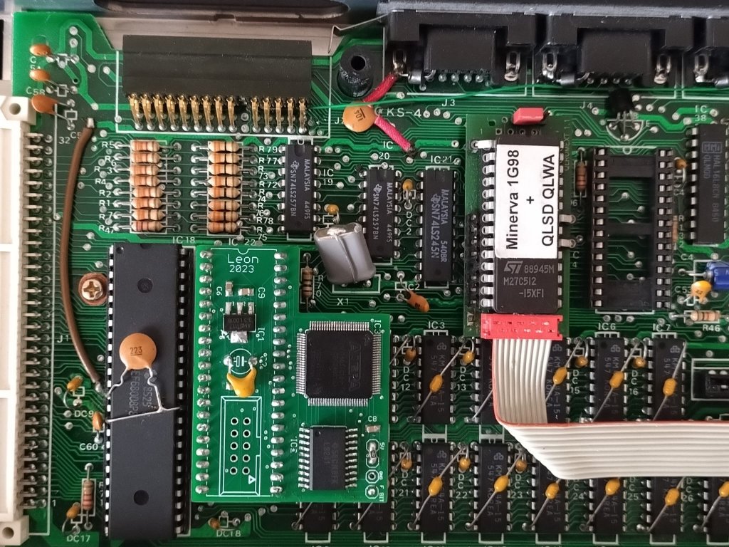

I also received a nes ULA replacement board, great quality, can not believe this was hand soldered.
I have ULA board installed in an Issue 5 QL, with Minvera v1.97, QIMSI, QL-SD, Tetroid TDI, with CF Inteface disabled. Connected to a RGB monitor.
Standard QL display looks very good, all Trump Card 896K is recognised, works correctly with QIMSI, and QL-SD configurations, with the updated QL-SD firmware.
Looks a very nice systen now.

Why? It works with the original ULA and the contact pressure should be higher with the thicker gold contacts now.
Zero effect of cleaning the contacts and re-seating.
I have two units and on both I can reproduce exactly the same message.
