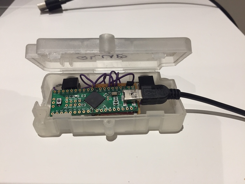

I'm highly impressed with the various cases, boards etc around this, so I thought by way of contrast I would post a pic of my highly professional effort here:
Note the use of a junction box from some old ceiling lights to project quality.
Also permanent marker
Just in case it's useful info, following on from testing with BLUE_scr, which was pretty much fine, I tried sending some more detailed graphic files (lots of Floyd-Steinberg dithering) and discovered that they worked a lot better with ndt_send set to 00B8h. Otherwise there was usually corruption. Again this is to an AH Issue 5.
