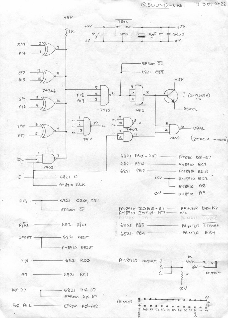

I'm not finish yet, because I have not time, and I need to read more documentation, because I'm not very familiar with the M68K architecture, but in any case, I do some experiment:
If disconect the VPA line, and conect it to DTACKL, (directly, or by a 1N4148 diode to the CE pin 20 of the eprom) and in both cases, the interface do not cause errors and PLAY work well, BUT I dont get any sound at all. (with 1.10 and 1.93)
If I connect both (VPA to pin 6 of 74LS03, and DTACKL throught a diode to inverse signal of VPA) there are errors and the QL hang.
So I suspect to a fault in the schematic, and we need aditional circuit to carry VPA only when access 6821 and DTACKL only when read de rom.

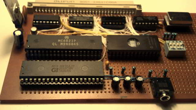

Well, it all works :) PLAY and QSOUND device perform as expected. (I removed EPROM and loaded image into RESPR)
I was using JS rom on 128K QL (slow memory) and got many errors, aalea is using 640K so in faster memory and got fewer errors. I previously copied EPROM several times (SBYTES) to see if any drop out occurred but nothing failed.
aalea wrote:So I suspect to a fault in the schematic, and we need aditional circuit to carry VPA only when access 6821 and DTACKL only when read de rom.
I suspect hardware timing problem. Be interesting to hear if Derek gets his original QSound board working and the results he gets. I can't think of anything missing from schematic.
(Ideally 6821 access should use 7473 (as suggested in Motorola 68K manual) and DTACKL for EPROM.)

Got it working from EPROM by making a couple of changes to hardware. DSL to pin 1 & 2 of 74LS03 (address decode). E to pin 12 & 13 of 74LS03, output pin 11 to pin 4 of 74LS03 (gate VPAL). I can only guess this is what tracks might do under 74LS03, puzzling thing is there would be no pull up resistor for pin 11 of 74LS03, which works without one (I haven't put one on mine yet).

Silvester wrote:Got it working from EPROM by making a couple of changes to hardware. DSL to pin 1 & 2 of 74LS03 (address decode). E to pin 12 & 13 of 74LS03, output pin 11 to pin 4 of 74LS03 (gate VPAL). I can only guess this is what tracks might do under 74LS03, puzzling thing is there would be no pull up resistor for pin 11 of 74LS03, which works without one (I haven't put one on mine yet).
Yes!, I confirm that it work correctly, I will update my project to reflect it, now we need one more version, with automatic address instead of fix to 0xC0000 :D

That's what the SPn lines are for - on a multi slot bus - these would increment from one slot to the next as a 4 bit number - when the address lines A17, A16, A15 and A14 match the SPn lines for logic state - the card is selected at that address represented - starting at 0x0C0000

I didn't wire to expansion SP0-SP3 but to DIP switches so I could force slot location and test direct access. But if the QSOUND device does not add too much overhead on slow 68008 QL then it could be argued we never need to know where it is in address map.
OTOH...
Before Super Gold card arrived with its printer port I has used a 8255 PIO chip in the QL I/O area ($18000-$1BFFF) as PAR port for plain Gold Card QL. The AY chip access could be done similarly, which would also work with SGC/GC systems (which don't offer E signal).

Pr0f wrote:That's what the SPn lines are for - on a multi slot bus - these would increment from one slot to the next as a 4 bit number - when the address lines A17, A16, A15 and A14 match the SPn lines for logic state - the card is selected at that address represented - starting at 0x0C0000
Yes, but to clarify:
This is the standar way, and the original ROM check the real position of the ROM, store the address in a system variable, and expect the PSG to be there.
MK79 made a custom ROM where the PGS is fixed in 0xC0000, So I was able to put the ROM in a cartridge, that is mapped in a diferent address of the PSG and do some test until silvester found the problem with the schematic.
Thats mean that If silvester move the ROM to another position with the dip switches, the orignal ROMS (1.10, 1.30...) wil work properly, but with the version 1.93 of MK79, don't get sound, only if mapped in 0x0C0000.
