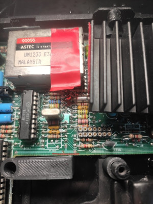

Hey, It's me again. :) I'm really not sure what is happening, but there might also be a fault with my QL. :D
At the bottom left side there is a cut trace, but I'm not sure if this is some sort of mod or it is a fault. I'm still struggling with my damn wires :D and I'm not sure if they are to be blamed. Yesterday that I managed to get it to "work", I cleaned this part of the PCB with IPA and It would appear that i made contact on some broken trace or something, at least that is my hopium now. I think my board revision is Issue 5.
Also is this the only schema:
https://www.sinclairql.net/srv/QLSchematicIssue5.gif
It's a bit difficult to read and I don't know why R98 is unpopulated, is this ok?
