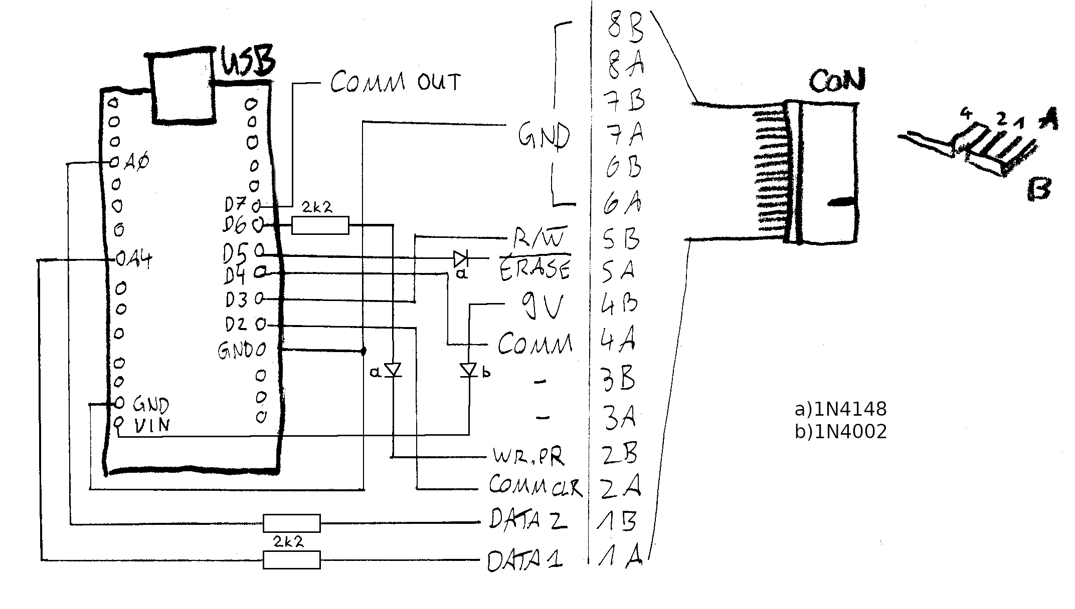

Ive cobbled together an oqtadrive adapter following this schematic:
I am using OSX (arm).
I have installed the 0.5.3 ino file to the arduino using the Arduino IDE software.
I have downloaded and run the 0.5.3 oqtactl software (arm).
I am able to visit the local website and subccesfully load a MDV file.
However, when I try to use the oqtadrive with my QL by doing f.e. `dir mdv3_' I get not found.
Here is a paste of my logs:
https://pastebin.com/ZJr1ZAaM
I checked, double checked, and triple checker my soldering, but found nothing out of the ordinary...
I am at a loss where to continue to debug this.
Would you be so kind and perhaps provide me with some feedback on what I can try next?

The log has very little info. Please set log level to DEBUG, then run the dir command on the QL, after that, get the log. I'm sure we can sort this out.
Edit: To set log level when starting the daemon, do this:
BTW, even though I'm quite fond of that hand drawn schematic you used
, I created this at the very beginning of the project. There is a more up-to-date version available now at the project home.

Attached you find the log running with debug.
As soon as I ahve it all connected AND power on the QL, the logging hangs/stops. (As seen yb the log)
[Edit:] I read on your project page to keep cables under 5cm, I have wiring that is longer (20cm from Arduino to Connector), I guess I should shorten them.
- oqtalog.zip
- (9.08 KiB) Downloaded 174 times
Re: OqtaDrive
From the log, we can see that the Nano is correctly flashed and serial communication works. However, it looks like there's tremendous noise at least on the COMMS_CLK line. When the QL idles, this signal should be low. However, the Nano repeatedly sees high at startup, which is why it erroneously detects your QL as a Spectrum (idle level is high there). After the initial sync it then constantly receives level changes an the COMMS_CLK line (that's all the CK CR OF DR messages), hence my suspicion about the noise.spkr wrote: Thu Nov 30, 2023 7:14 pm Attached you find the log running with debug.
As soon as I have it all connected AND power on the QL, the logging hangs/stops. (As seen yb the log)
What happens when you reset the Nano in this situation?
This could actually be a reason. If you have an oscilloscope, you could check on the COMMS_CLK line. A faulty Nano could also be a cause, so if you have a second one, you could swap it out and check whether that changes anything.[Edit:] I read on your project page to keep cables under 5cm, I have wiring that is longer (20cm from Arduino to Connector), I guess I should shorten them.
If I understood correctly, you attach OqtaDrive to the Microdrive edge connector of your QL. Are the two internal drives still present and both work, i.e. do they at least briefly spin up when doing 'dir mdv1_' and 'dir mdv2_' ?
EDIT: A broken COMMS_CLK line could also cause the observed effect. I remember seeing similar log messages when I forgot to plug in the adapter. COMMS_CLK is floating in that case and can easily cause this. So checking the cable for continuity would be another idea.
