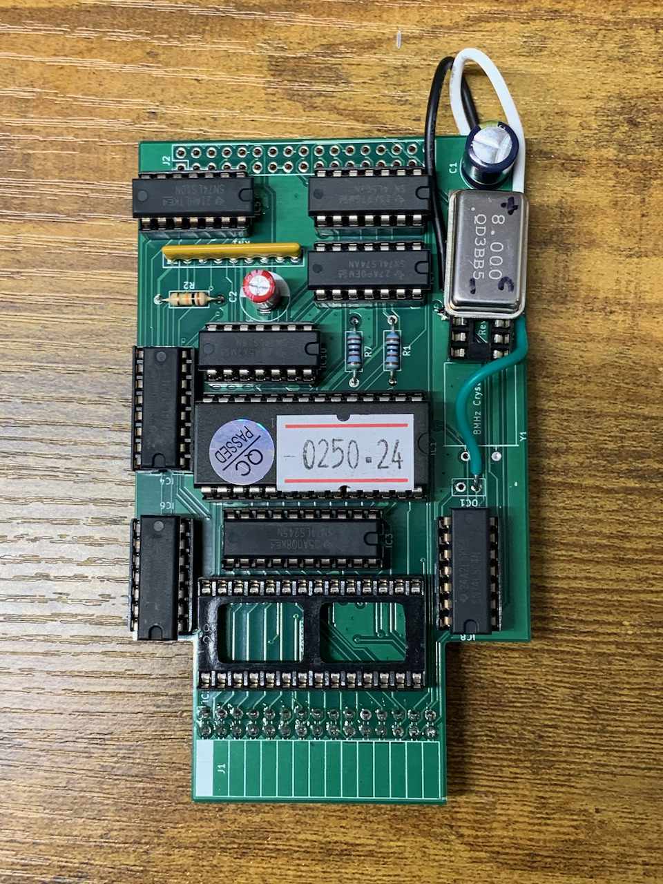

Just for the record, here is my Mk.I disk interface board as a KiCAD project.
Note that the pins on the connector to the ROMpack are the wrong way around so the right-angled socket has to go on the "solder side" of the board.
Also, the clock circuit doesn't work so instead of a capacitor and crystal it needs an 8MHz crystal oscillator connected to the 74LS04 side capacitor pad and powered from the large power capacitor pads.
If you want to use a larger EPROM, link pins 1 and 27 of the ROM socket to ground.

Trying to understand the circuit around the crystal, it looks like a 1pF capacitor in the feedback loop with the crystal?
Re: ICL OPD
Actually - I just noticed it's marked all your capacitors as 1pF. I think I get the circuit now, and I think I know why it might not be oscillating - the 2 74LS04's that are wired around the crystal should have some feedback resistors between input and output - this will bias them into the linear mode - that should then create the oscillator circuit you need. The 3rd gate tied to the output of this oscillator circuit will 'square' up the clock and provide a cleaner signal to the WD1772 clock input. Of course all 3 of those gates could be removed and just use a crystal oscillator can.

I copied the crystal circuit from the PCB traces. The capacitor values were not specified on the documentation I had and the cap on the crystal circuit was small and ceramic in the pictures of the board. Anyway, a crystal oscillator is far better, as per my hack.
The design philosophy for this mark 1 board was to replicate the original circuit exactly. I could then improve it in later versions. I can reduce the chip count by at least one, maybe two using a GAL for a start.

I was thinking about the possibility of reduction - I think you could get away with:
Crystal oscilator
WD1772
A GAL - possibly even just 16V8 size
An LS240 or equival(for buffering disk drive signals)
An Eprom / Flash
An LS174 / LS175 latch
It's teasing my brain now
Crystal oscilator
WD1772
An Eprom / Flash

I noticed that in circuit - the DDEN pin is grounded on the WD1772, in QL disk interface designs - this is often fed from a latch so the density can be controlled - do you know off hand what density this interace uses - is it 360K or 720K ? I see in the various pictures it's using a 3.5" floppy - so presumably a double density 3.5"?
