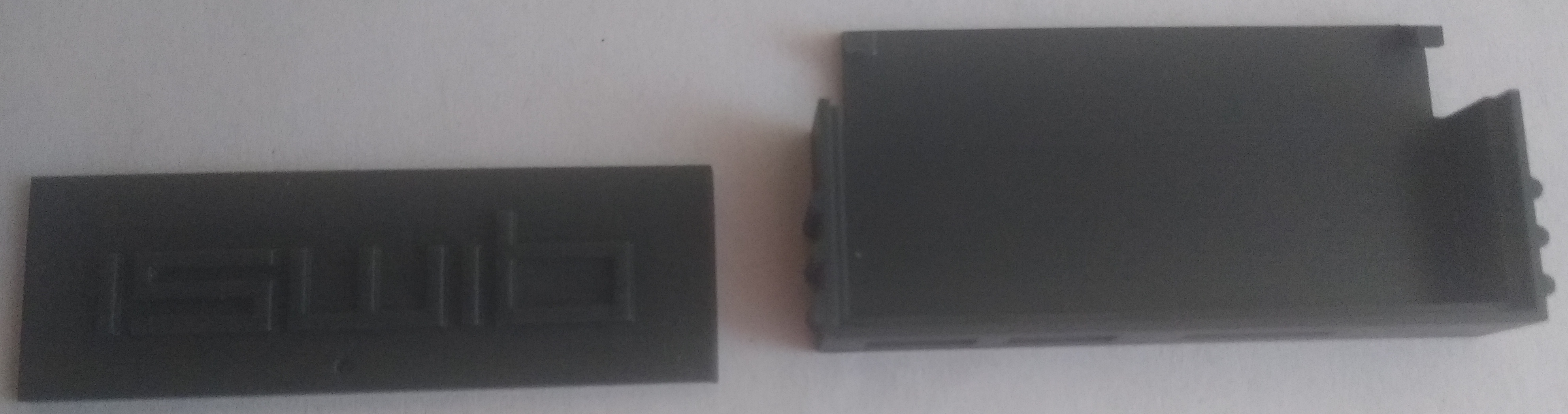

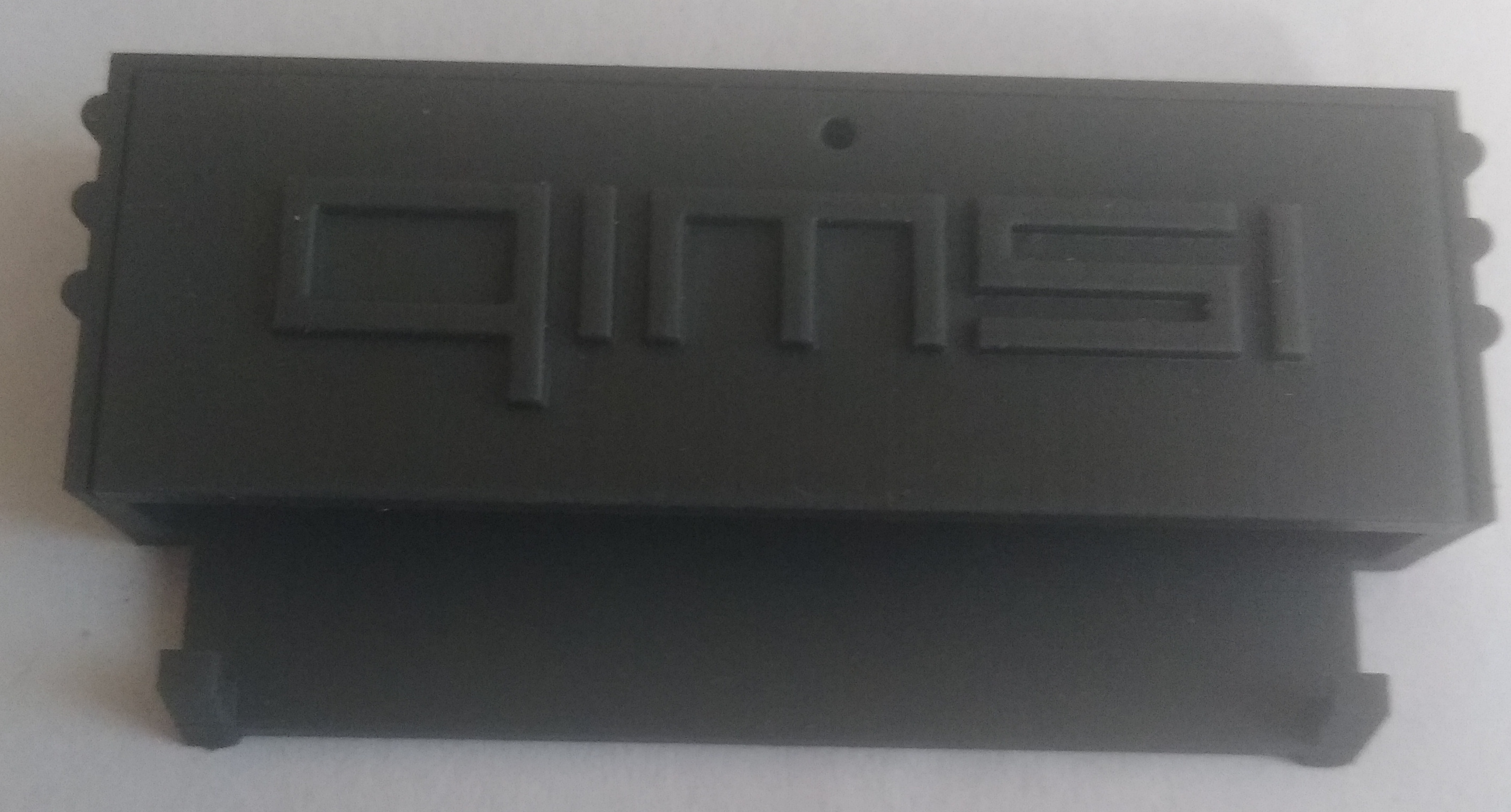

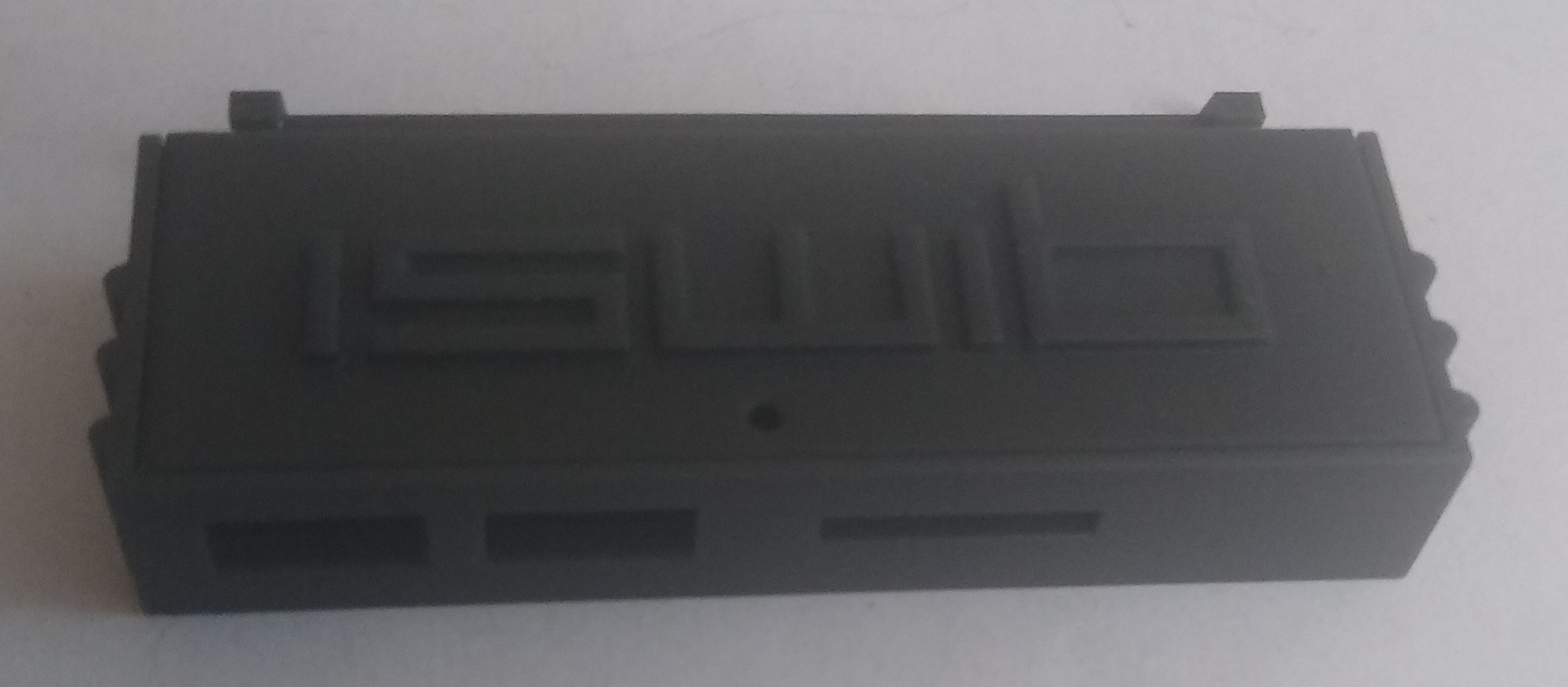

I have had a 3D Print of the QIMSI case, with a Resin printer. This gives a smoother print finish than PLA Prints.
I have done an optional detachable top, or a complete case.
There are pictures of the detachable top case: The case can be s single unit, but I liked the idea of a top that could be removed.

Derek_Stewart wrote: Wed Nov 15, 2023 8:47 pm Hi,
- Posts: 4755
Re: Breaking news: The QIMSI Interface
Initially, I made an error sending the wrong STLs for printing, the case should been a single piece.
But the resultant 2 piece case does allow access to the serial port connector, but there maybe a better solution.
If required, I can get prices on the 2 types of case.
