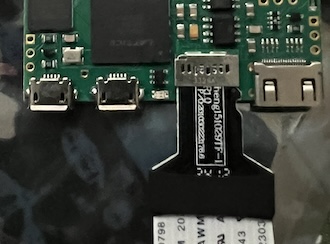

In typical "what if" testing - and after speaking with Stephan who was able to point me in the right direction for getting the QIMSI Gold to work - I wanted to test if the SD card switchers you can find on eBay will work with the QIMSI.
I am happy to report - yes they do - but there are some caveats!
1. The interface board is a long L shape - and it is tight on space - it will almost certainly foul on the HDMI cable
2. I had swapped the QL's over and after selling the JS ROMS in the test QL and replacing them with JM Roms (it would not have made any difference either way), the keyboard drivers from Jan don't work as they need a Minerva - Doh!
3. The board does look a little 'flimsy', so long term use and the durability of the switch - not sure...
4. Lastly - the SD sockets are the click in type - that's ok, but extracting the SD cards is tricky as they 'catch' in the SD socket.

Why would you want it? It would allow you to chose to either boot into QIMSI mode or QIMSI Gold mode, useful if you want to retain the possibility of using the SD card capability and external keyboard and mouse but plug something into the edge connector.

I ordered an extender so I could bring the card slot to the front for easy card changing, but it turned out to be 'T' shaped (because the main ribbon cable is a lot wider than Micro-sd) which means it fouls the HDMI portPr0f wrote: Sun Jul 21, 2024 5:07 pm 1. The interface board is a long L shape - and it is tight on space - it will almost certainly foul on the HDMI cable

I do not like the look of this, it looks like an accident waiting to happen. Just be careful not to damage the Micro SD Card socket, they are hard to repair.
I accidently pulled off the mouse connector on my on QIMSI interface, prior to having a case. Fortunately, the connector only pulled a connector securing pad from the PCB, the electrical connections, were lightly soldered and looked like they peeled off the soldered contacts.
I glued the Mouse connector back onto the QIMSI PCB, for more support.
The soldered connections are very fine and were soldered carefully, with a fine tipped soldering iron. All working now, in a custom case, with removable top.
I would use the option of utilising QLSD EXTboard mod to use the QLSD Reader fitted tomthe front of the QL. Which means the QIMSI Gold SD Card slot is not used.
