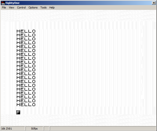

I finally set up my TS1000. I had forgotten how bad the RF modulation on the old TS1000/ZX81's were. I had to do some adjustments to make it a clear as possible. The QL RF modulator is so much better. I may have to do the composite mod on the TS1000. The EightyOne emulator lets you simulate the old screen interference so I recreated something similar to what I'm getting. I also have my original ZX81 that I haven't unboxed and wondering if its screen will be better.
In any case, I did some timings and had some surprising results. With this code, BBQL comes in 3rd about 2.7 time slower than actual TS1000. EightyOne is almost twice as fast as TS1000 which is surprising since I thought it is supposed to be pretty close to realtime esp since EightyOne is running at the lower frame-rate. This test is a bit contrived as I'm trying to squeeze the most out of the TS1000 speed-wise.
This next example has different results, now BBQL is 2nd only to the EighyOne emulator and actually beats the TS1000 hardware.
I think ZXSimulator is slightly slower than the EightyOne emulator but it may now actually be on par with the actual hardware TS1000 when you start adding the various commands that make up most BASIC programs. Of course once I add floating point we will see how it fares.
10 PRINT "HELLO";
20 GOTO 10
- EightyOne running at 50fps for the ZX81 - 2 second
- Actual TS1000 w/16K Ram Pack - 3.5 seconds
- QLAY2 running ZXSimulator (speed 120/delay 1200) - 10.5 seconds
- Unexpanded QL running ZXSimulator - 9.5 seconds
10 FOR I=1 TO 20
20 PRINT "HELLO"
30 NEXT I
- EightyOne running at 50fps for the ZX81 - 1.30 second
- Actual TS1000 w/16K Ram Pack - 2.15 seconds
- QLAY2 running ZXSimulator (speed 120/delay 1200) - 1.70 seconds
- Unexpanded QL running ZXSimulator - 1.60 seconds

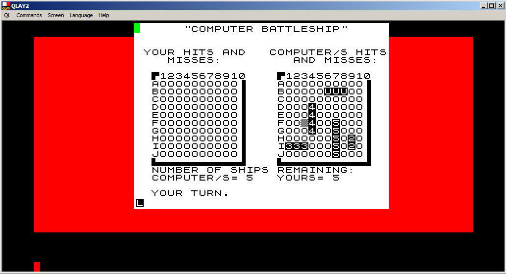

I was finally able to recover my ZX81/TS1000 game BATTLESHIP that I wrote as a teenager. I had submitted it for publication and Gladstone Electronics had sent me a reply that they were in the process of crafting a contract and boom, Timex pulled out of the US market (the whole process took 3-4 months so had I been a year earlier this might have appeared on Cassette's for the TS1000).
I made two small changes to work with the ZXSimulator. My PAUSE is uninterruptible, which I need to fix since you can break pausing with any keystroke on the ZX81/TS1000 so I removed it and replaced it with an IF/GOTO (line 90). Also, grabbing INKEY$ is better if you do it once and assign to a variable so I added that, although it was working without that fix (line 962). The one ZXSimulator bug is when comparing strings via = in an expression which turns + into concatenation of strings so had to add VAL (line 970 and 975). But that's it, otherwise it is unchanged.
Note that once I got it loaded into the TS1000 through an audacity captured wave file on my desktop, I took 30 screen shots with my iPhone and typed it in since the EightyOne emulator refused to read the actual audio (and the Java based conversion tool gave me endless errors with no hope in sight). So perhaps there are still a few typos that I need to fix but I did play through a few games (finding like half a dozen typos that caused the game to crash) and I beat the computer once and it beat me once. What's nice about this (and l likely why it was publishable) is that the game has a nice pace and the computer talks to you so there is a bit of a "script" that I created for the user. When I create stuff now, user experience be damned but I guess as a teenager I thought about it.
This game is almost 40 years old:
Update: fixed some typos but found no bugs. Also updated the picture since some of the text on the computer's end was off by 2 spaces.

Re: ZXSimulator
Latest version of ZXSimulator. A few small but helpful changes:
You will see that the source file has been zipped as the distribution has gotten a bit too big to fit into 128KB of MDV storage. So you have a zip file inside of a zip file :-/ You'll have to unzip src_zip if you wanna take a look of the C code for the simulator.
Note that I added a 4th program, my Battleship_bas game that I wrote as a teenager in the early 80's on my ZX81. I reclaimed it and left it mostly as is. I had to type it in since I was only able to load the tape onto a TS1000 and then took screen shots. I think I fixed all the typos. I changed a few lines where I was doing this:
To the code below as it works better with how INKEY$ is implemented via a QL TRAP.
So without this you can be pressing a key and it just doesn't always registers it, especially on a fast machine (QLAY2 for me). So assigning the INKEY$ to the K$ variable seems to capture more key presses. I did the same thing in the Ball_bas program previously. Note that INKEY$ isn't all that great on a ZX81/TS1000 either.
I may change the Battleship_bas program like I did with the minesweeper game and tie both setting ships and picking spots to joystick port 1 so you don't have to use the keyboard. Still, I designed it this way (I think -- been almost 40 years) because that's how battleship works, giving coordinates. I must have decided that being able to have a moving/blinking cursor was also cool since setup is done that way.
BTW, there is a bug during setup that when you cross an already placed ship, the cursor will overwrite it. Oh, and if you try to set a ship off the board nothing happens...sometimes that can be confusing -- I should have added an error message.
- Changed file reading to be a bit more efficient. It now determines size of file, allocates that memory, and reads it in
- This has sped up file loading a lot
- Before I was constantly resizing my internal store and copying from small to large which was mucking up the heap
- Now I can load larger BASIC files with less memory (i.e. BBQL can load 13K Battleship_bas)
- Need to figure out a better way to determine file size -- right now I read it twice (whats a good way to get file size via TRAPS?)
- PAUSE now can be aborted. I basically pause for 5 milliseconds and check for key presses (should likely eat those presses as well but am not)
- Listing was broken for rare case of double-wrap where the 3rd line left a single character
- Display wasn't quite centered -- fixed
- String concatenation and equality now works properly and won't muck up in lengthy expressions with mixed types
