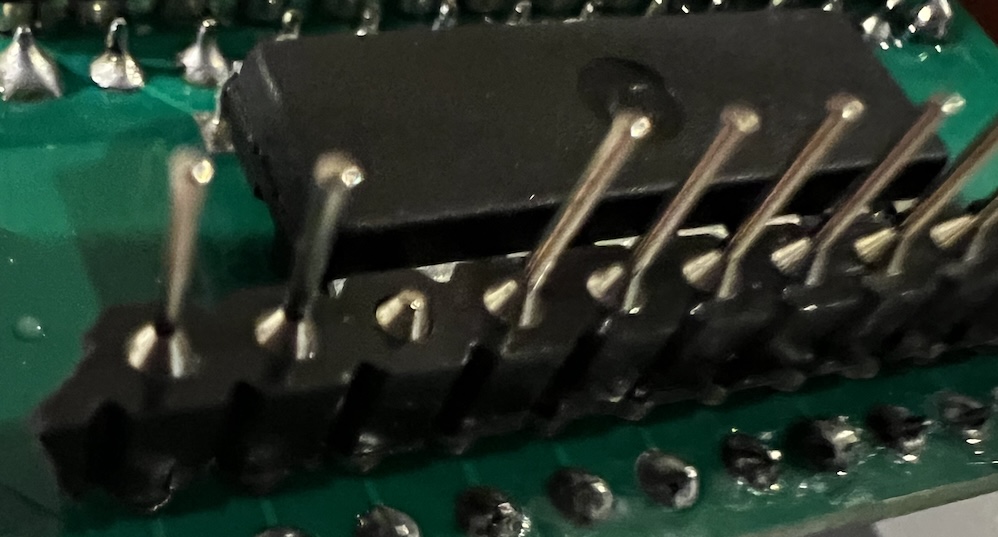

It’s the legs on the bottom of the board that plug into the QL Rom socket.
But the strip of pins are the ones that are soldered to the PCB underneath the soldered EPROM so the only way to replace the strip of pins is to de-solder the EPROM as well
It’s also such a jigsaw that it’s simpler to just build a new board (I still have 3 complete sets of components)

Actually, maybe I can just solder a pin onto the remaining stub?
I'd just be a bit wary of it snapping off in a QL socket, but I guess it would be possible to extract it

I would try to desolder the remaining pin instead and just replacing it by taking the pin from another socket. Depends on type of socket though.

Trouble I have is, I can’t access the pin top to de-solder/solder as it’s underneath a soldered eprom

Have managed to solder a leg back on and was able to put it in a socket and remove without the leg falling off! (for now at least)
The QL it's for is packed away now for storage, so just gave it a quick test in the viglen I've attached to my main QL
