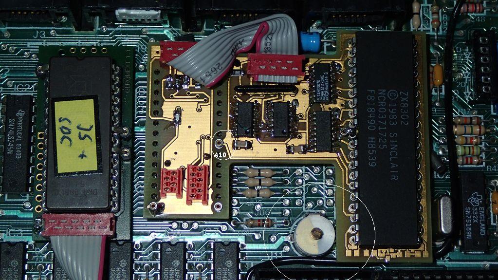

Hi Phill,

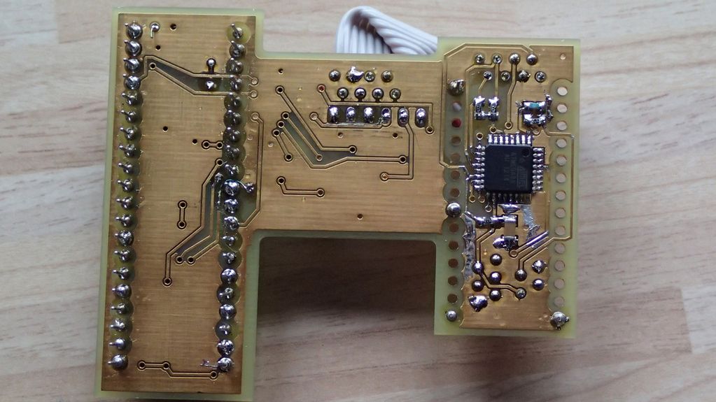

before you go ahead with your design for a professionell pcb, please take in account that there is still a space problem. Your board is blocking a trimmer on issue 5 boards. Then axle of the trimmer is high enought to cause short circuits. I showed the postion on the picture. That the reason why my board has the same shape like the orginal one. The PS/2 converter is under the Eprom and connected via a ribbon cable to the Qimi circuit. That also enables you to use the Atari and Amiga mouse instead of a PS/2 mouse.
The Eprom socket is not equiped with all pins, due to the fact that only A10 is used.
QLObi
Bottom side with PS/2 converter
Top side
Top side

QLObi wrote:Hi Phill,
I did check with a printed layout on an Issue 5 board, and it seemed to just fit, I will check the clearance tonight on one of my issue 5 machines. I have slightly moved the board edges in that area for the next version so hopefully that will solve the problem :)
looking at your picture the axle sticks up just slightly further down the board than pin 19 of the ZX8302, in which case there shouldn't be a problem as the edge of the board in the next version is about in the middle of pin 18, so about 1.5mm away, but will test tonight all the same :)
I may do this also, have an option for an Atari / Amiga mouse, with the right AVR you may even be able to add a USB mouse :)

Ok, I checked the current board in an issue 5 machine and it misses the axle of the capacitor....and it works too :)
I'll post a piccie later this evening.
Cheers.
Phill.
