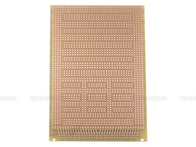

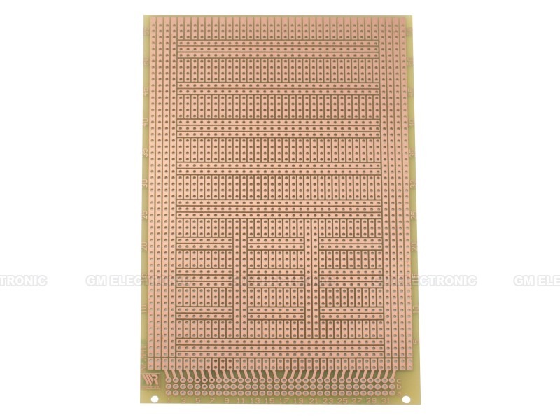

I was also considering PCB prototype board as one seen on the picture, to test design while not certain but QL forum seems helpfull in this respect.
TCAT
prototype PCB board
prototype PCB board

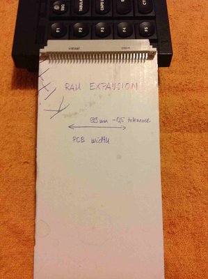

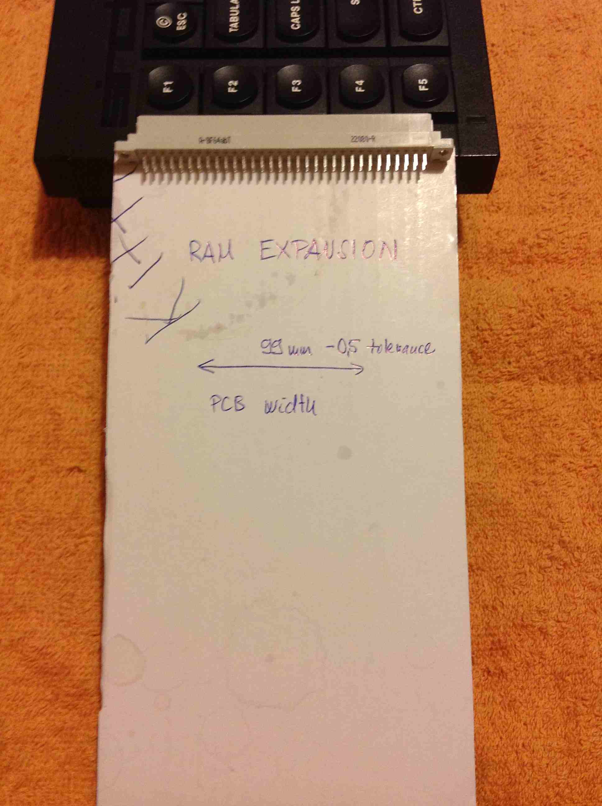

Trying to asses the ideal PCB width.
I have only a connector with straight pins, 90 degree angle pins would be better.
I taped it onto the cardboard edge, it inserts inside QL more or less smoothly.
TCAT

prime
Posts: 192
Joined: Fri Feb 18, 2011 8:58 pm
Re: DIY RAM EXPANSION
Post by prime »
The DIN41462 connectors and the QL expansion cards are designed around Eurocard boards that are 100mm wide, and whatever length is needed.
Cheers.
Phill.
Posts: 2878
Half eurocard. The nominal size is 100x160mm, but some QL bases vary and have a guide that creates a limit of 98.5mm if you want the connector to line up straight and true. For this reason, I design boards with a nominal 97mm height.
I always, when discussing a board, think of as having directions and a specific orientation. Up, top, and back all refer to the back edge of the board. Down, bottom or front refer to the edge nearest the user. Right is the female connector facing the QL, and left is the thru-connector to other hardware, or sockets and expansions. This was taught to me by Arnie Gardner at Sandy. Apparently, some people considered the QL connector edge as "bottom" and this caused a couple of expensive or timewasting miscommunications between different QL accessory companies when we communicated with each other. Thus a standard was agreed.
With PC boards, the edge facing the back of the case is always the up, top or back of the board.

prime wrote:The DIN41462 connectors and the QL expansion cards are designed around Eurocard boards that are 100mm wide, and whatever length is needed.
Right. 50 cm, at least... :D
But if you're not fitting an angled connector (Dave can tell you where to get them cheap ;) ) your card moves up in the slot into more narrow space.
Do yourself a favor and get the proper connector - It will get quite a bit fiddly to insert the card if its not at the correct height.
