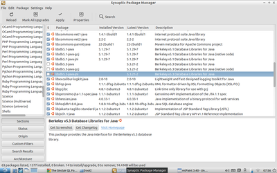

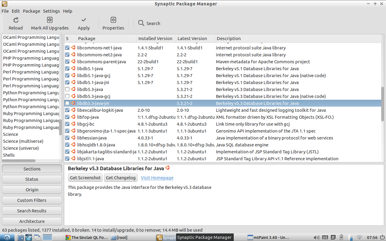

I can only assume JAVA isn't installed correctly, so I have tried the package manager.
Below you can see the screen shot of the package manager, this does seem a longwinded process to install. there are three different JAVA things to install so I am making my way through the first one. Manually clicking and confirming each tick box to mark it for installing. So far all you can see has been installed except for three blanks, one of which is highlighted. when I do mark it a red broken sign comes up, when I try to APPLY this it says its a broken package FIX first. Fixing is in the EDIT drop down, but that fails to fix the package saying:
- E: Unable to correct problems, you have held broken packages.
E: Error, pkgProblemResolver::Resolve generated breaks, this may be caused by held packages.
E: Unable to correct dependencies
So I am unable to find out what a held package
I'm thinking of a reinstall of Lubuntu as I suspect just deleting the folder of JAVA and starting again won't resolve the problem.
BTW I cannot find in the package manager any other way of installing a package other than from this pre-filled list (it seems like luck that three different JAVA packages were in there), I would have thought a simpler way would have manifested itself, as the command line process looks simpler.
