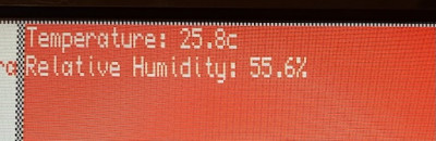

This is the TEST program for the HTU-21D (will eventually write an extension for it in assembler)
No error checking as it's just for testing

And a sample output from it
Again, thanks to all
