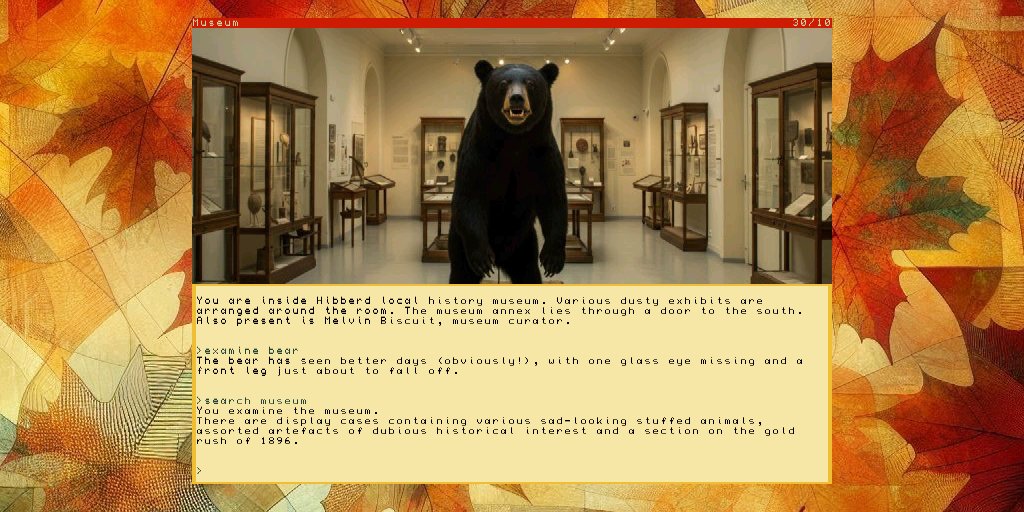

Back again, just to say the files have been updated. The links in the message above now give the latest versions. Sample screenshots below...
Edit 13/4: Bug fix. If you downloaded the games before today, please download again, as I just discovered an unfortunate bug that gives away the ending. I managed to overwrite an error message with the text for the ending. That's where a beta tester would cone in handy.
