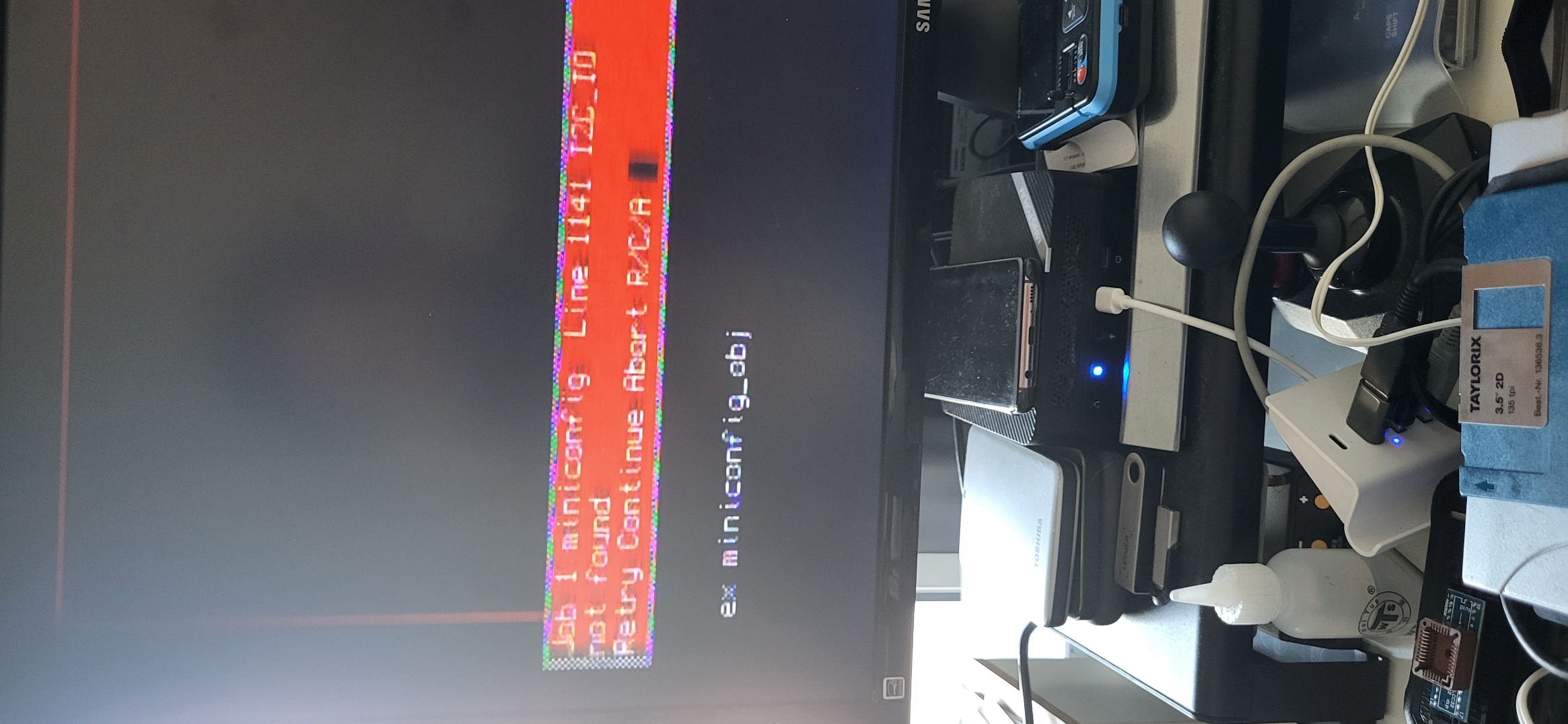

Using miniconfig_bas from tk disk.
AFAIK minicomfig_bas is intended to be compiled and need some toolkits.
In the Minerva utils there is also a miniconfig_obj that is the _bas file compiled and no need anything more.
Try to execute it with ex.

HI Alvaro, thank you for the reply.
Indeed I tried the _obj as well but still getting an error..
At the beggining I tought would be headers missing due to unziping as I couldnt remenber how I had created the TK disk, but after properly creating an new one error is still there.
(I am also using your minitrump (tc2.19) which comes with tk2.26)
. I2C_IO is present on flp1_ as well
. looks like both the compiled and the _bas version fail at the same point

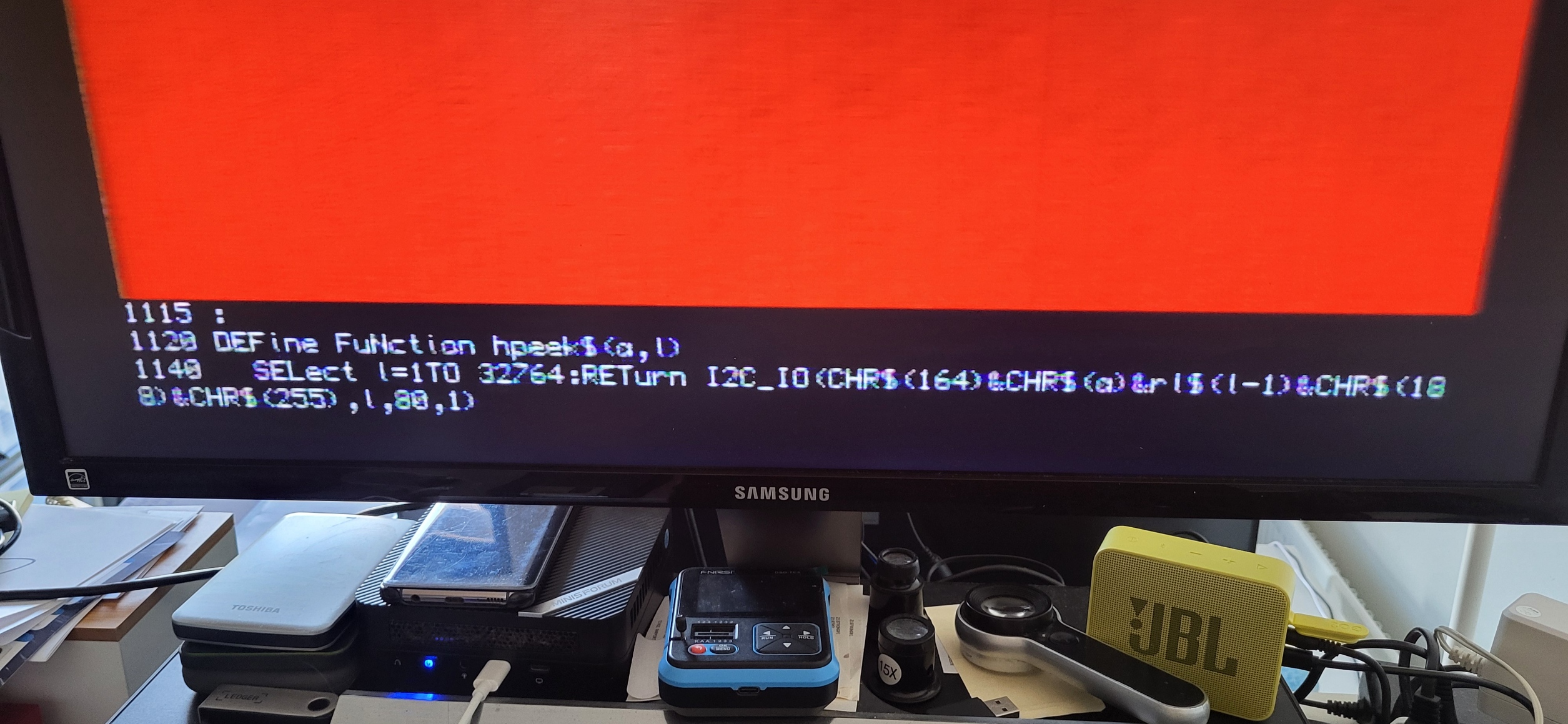

your configuration program can not find the I2C_IO file.
Look at the error line and change the file path to suit.
The miniconfig_bas program from the Minerva Utilities disk, requires the resident extension: I2C_IO_BIN to be on the FLP1_ disk.
The compiled version is not really required, as the Superbasic version will do the job.

Derek_Stewart wrote: Wed Apr 30, 2025 9:05 am Hi,

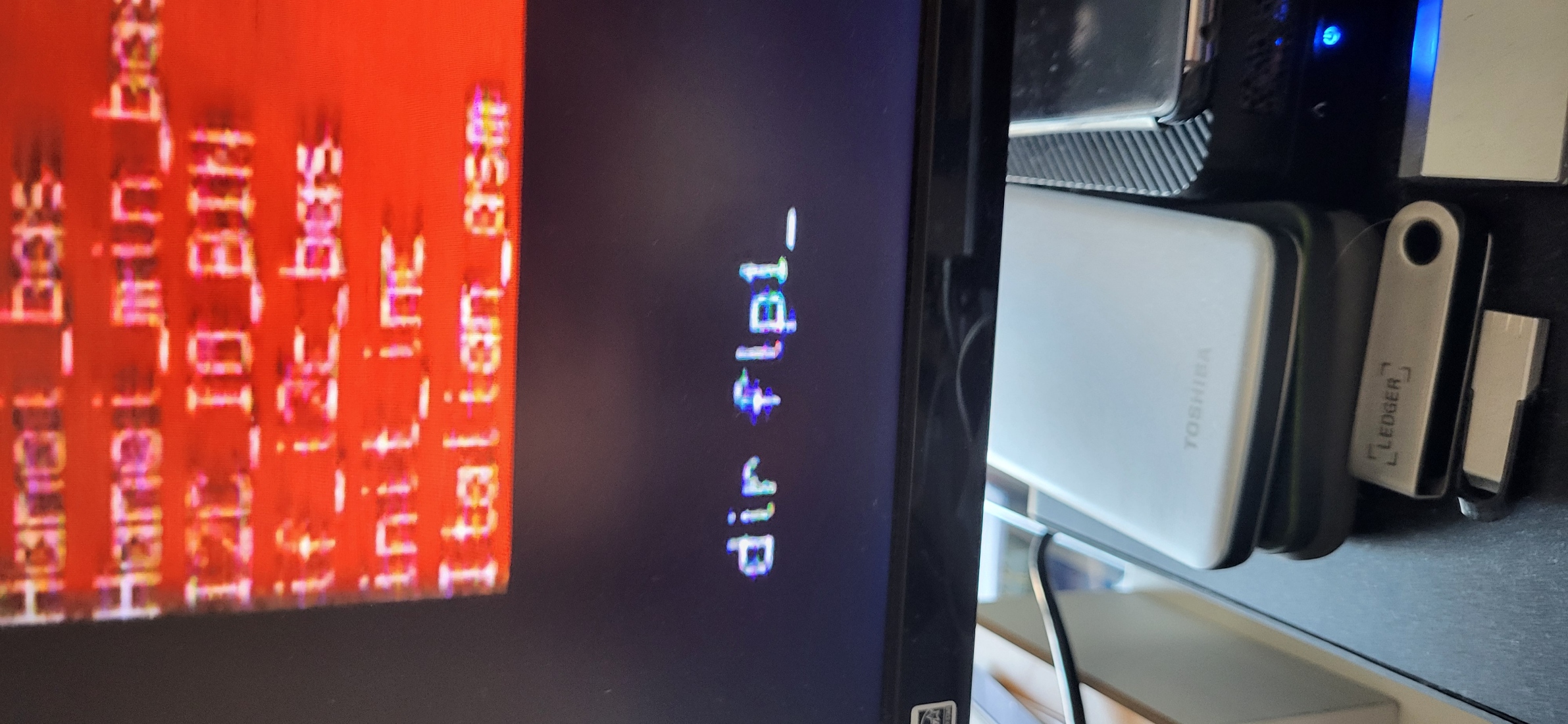

- I2C_IO_BIN IS on flp1_
- the line referenced in the error is this one:
1140   SELect l=1TO 32764:RETurn I2C_IO(CHR$(164)&CHR$(a)&rl$(l-1)&CHR$(188)&CHR$(255),l,80,1)
- I have tried changing the path to flp1_I2C_IO and flp1_I2C_BIN -same error
- Also tried using data_use to point to flp1_ -same error
Perhaps I am missing some basics? Not the most savvy ql user here tbh.

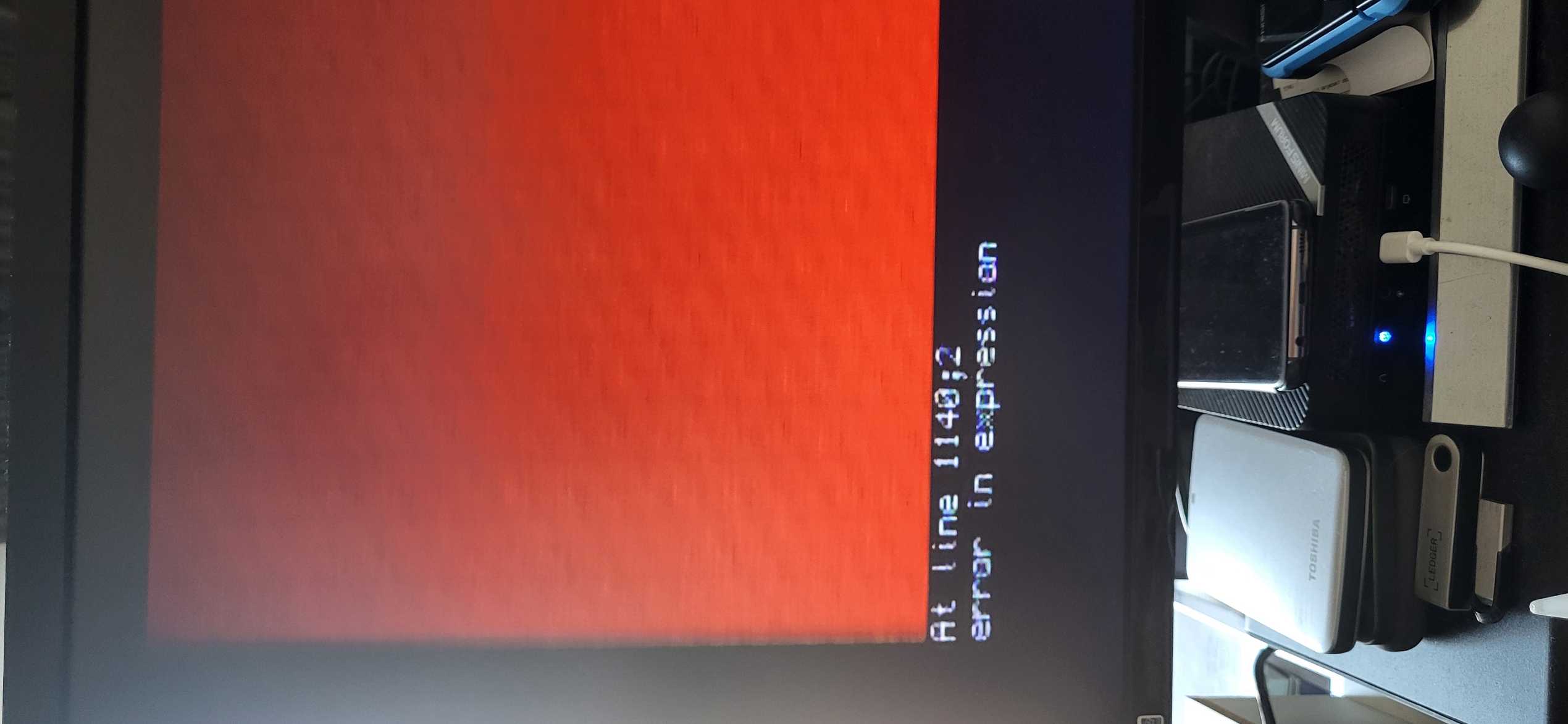

While running miniconfig_bas I had the "At line 1140;2 error in expression"
Then I LRESPR i2c_io_bin (as mentioned by @Arleybls) and now I have "At line 1140;2 format failed"
It seems that I2C_IO is still not working...
Any help appreciated cause I ran out of ideas :-(
