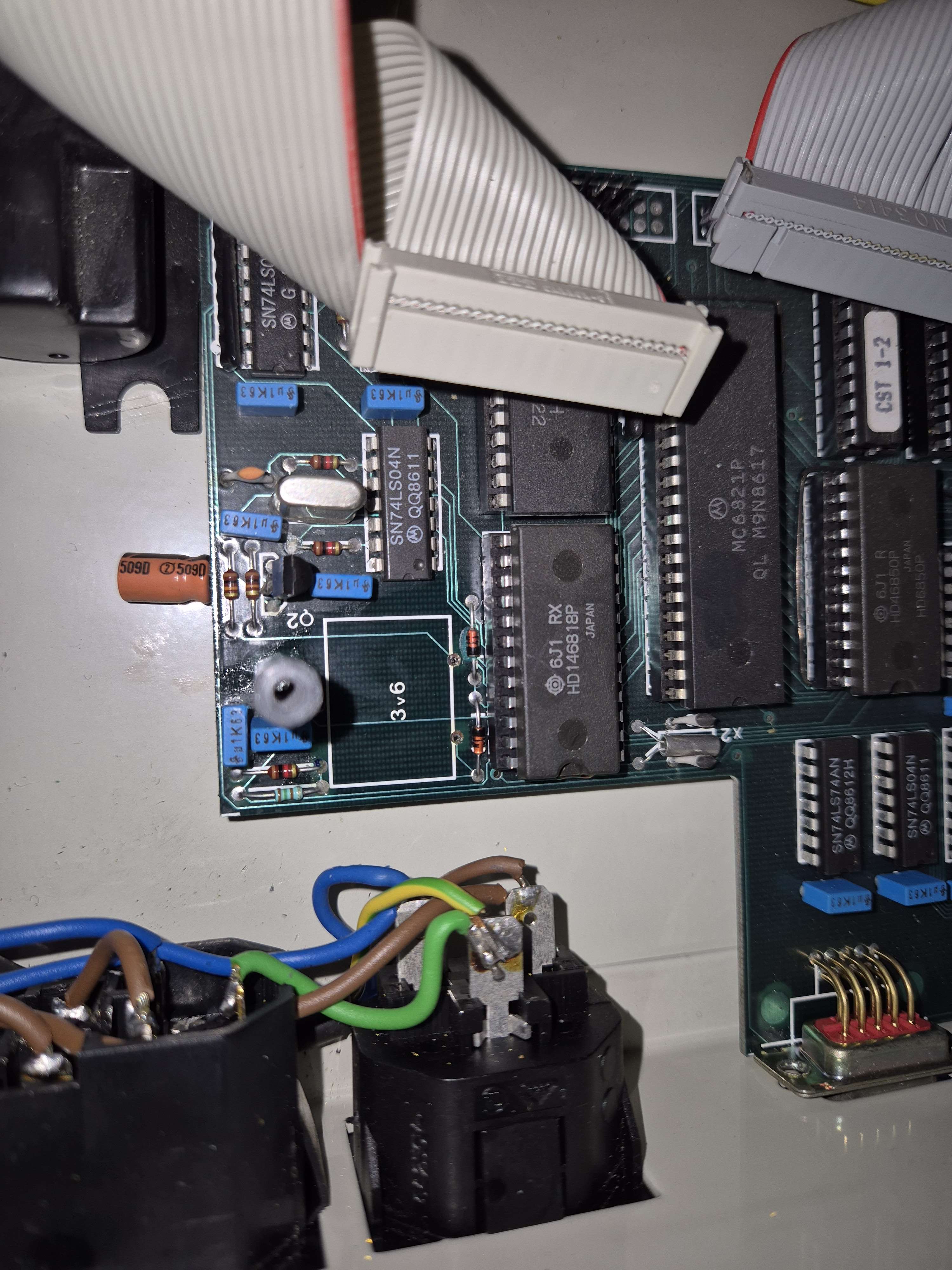

So I will fit QL board into the case, with a ROM expansion board,
Posts: 2853
Re: CST Thor 21
After a good battle, I got the battery out. Hardly any leakage, but gave the area a clean with some red deoxit.
PSU needs a full recap yet.
