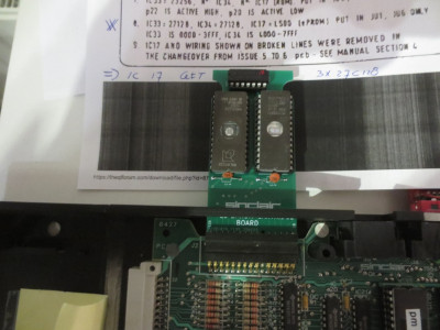

mmm, something must be wrong ;
i verified all eproms , verified the 2 7400's

I am not sure, but i think the eprom ic on the kludge should be in the left ic socket.

chriskgnr wrote: Sun Mar 09, 2025 4:15 pm I am not sure, but i think the eprom ic on the kludge should be in the left ic socket.
I think you're right. Looking at the schematic, the #CE line of IC2 is enabled with both A14 and A15 being high. I.e. address 0xC000.

eprom and ls00 verified again , placed in the left socket does not change anything .
Anyone got a working eprom for verification ?

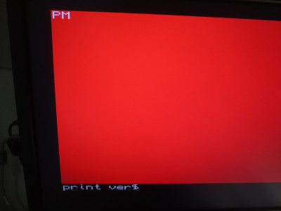

The picture you put above of the QL nearly booting is what I'd expect to see if the end part of the ROM was 'missing' so if I take a standard QL and remove the second ROM ic , then this is roughly what I would see. I don't think the third part of the ROM is going to the correct address
jobdone
Posts: 116
Re: resurrecting one time the original rom plus kludge
Post by jobdone »
I also tested this with a PM ROM on qemulator, splitting it in 3, then joining the first two parts back. The first two I placed in the ROM and the third part went in the back ROM. I saw exactly the picture you are showing above.

SOLUTION ;
27256 with 2 x 3th eprom image .
in the left socket , and
tkII 27128 in the right socket
the result ;
