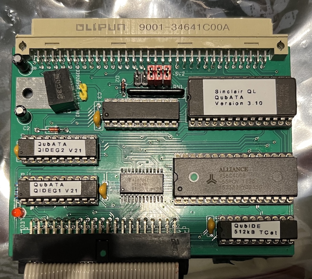

For what it's worth I have the same CF adaptor as yourself. I'm using a qubide clone (a QubATA these days). Mine is powered via the card.

What ROM Image are you using on the Qubide clone?
Posts: 1590
Re: Power Problem with CF Adapter (on QUBIDE)
ah, I see you answered in the post - which version of Qubata ?
Posts: 1056
It's 3.10 by the looks of it

3.11 now. I have used this card with 1.56 qubide rom and 3.10 qubata too all with the same adaptor and card.

one thing I noticed the other day was that I'd managed to bend one of my jumper pins (the one near the 7805) . I realized that if I managed to bend that over and it touches it's game over! so I may actually remove that header.

jobdone wrote: Tue Feb 25, 2025 8:39 pm one thing I noticed the other day was that I'd managed to bend one of my jumper pins (the one near the 7805) . I realized that if I managed to bend that over and it touches it's game over! so I may actually remove that header.
Is that the yellow header? Any idea what it’s for please?

yes, it's to bypass the voltage regulator, so if you had a powered backplane (5v) you could use that instead. doing so without one will put 9v into your card...

jobdone wrote: Tue Feb 25, 2025 8:43 pm yes, it's to bypass the voltage regulator, so if you had a powered backplane (5v) you could use that instead. doing so without one will put 9v into your card...
I’d better be careful!
