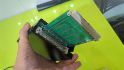

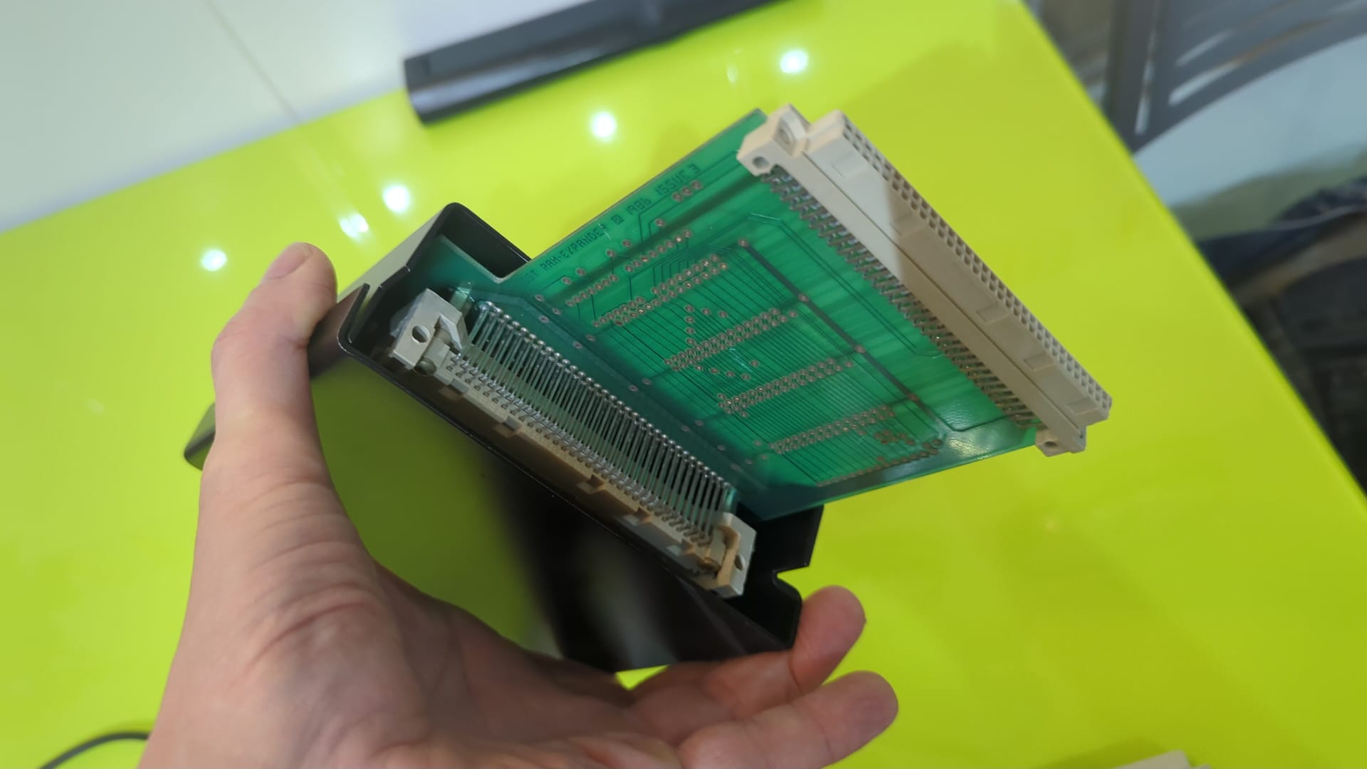

Can some one identify this expander board?
A friend sent me this pictures, but I'm not sure if is a memory expansion or the Q+2 that your talking, by the text on the board, the unpopulated ROMs in the pcb and the detail that the top board can't be easy removed.

That's the CST unit - CST RAM Plus - it's a 512K memory expansion, plus 4 Eprom positions (upto 32K each I believe - sockets and additional components not usually fitted for these ROM positions) and an additional bay to take another expansion card.

You can populate it with 4x 16k roms, as well as 4x 32k - after talking to Simon Goodwin who owns one.

nothing to stop you adding 2 16K images together and making a 32K rom image - the QL's ROM scan logic will be looking for 16K ROM's anyway - so if you have 2 ROM's concatanated together to make a 32K then it will find both ROM's.
The only caveat with this - if the ROM images are less than 16K in size, you will need to fill the empty space upto the 16K boundary - so that both ROM images start on a 16K boundary - regardless of length.
You can do this in a Hex editor, or some ROM programmers will let you manage the location of a ROM within the workspace before programming it.

Agreed. But for users like me, without the equipment or knowhow, fitting existing roms taken from a cartridge would be easier than trying to find someone to make a 32k.
The downside of course is you have less software on the board. The other thing if I did get a Ramplus, is having one readily soldered to accept roms. My soldering is shite and I've never really done any.
