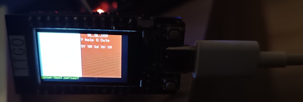

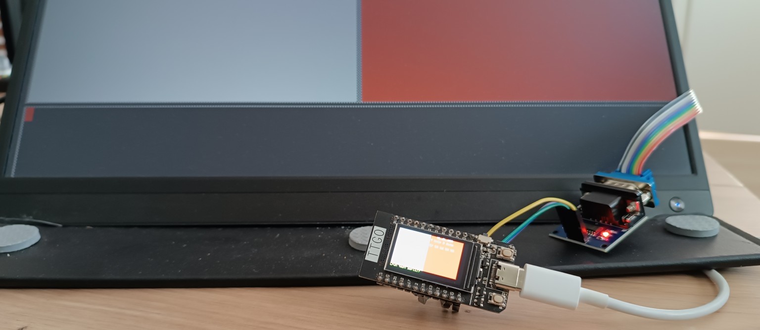

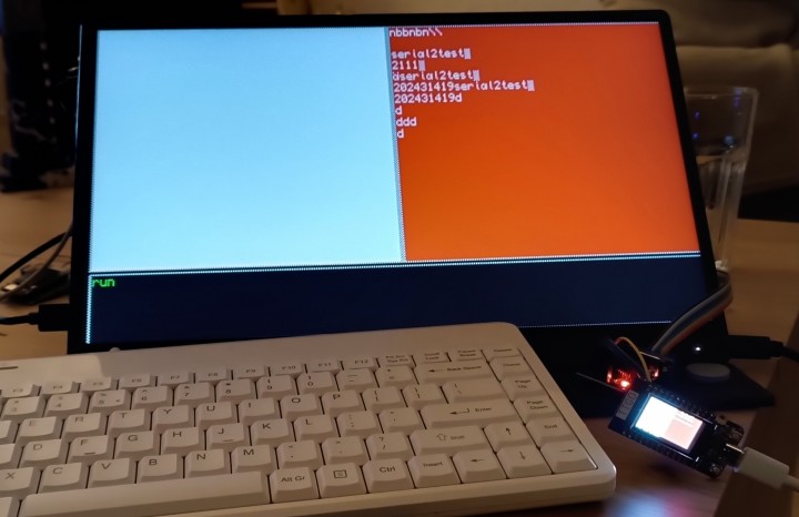

Hey t0nyt;
I think youre idea is great for getting the time.
But what about NTP time?
I am currently testing an ESP32 the TTGO T-Display + an rs232 to TTL print.
My goal is to be able to perform modem like commands from ql to ESP32.
Which would give many possibilities
The ESP32 Connects to Internet and gets the NTP time.
At the moment Ive got NTP working.
The QL can send serial a command <d>
And the ESP32 T-display will answer serial the NTP time.
This already works ok.
There are many things more one could think of, like getting the weather send a telegram message etc. etc.
Maybe an idea for you?
