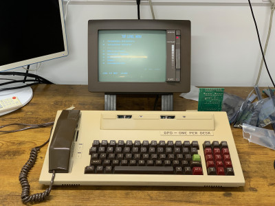

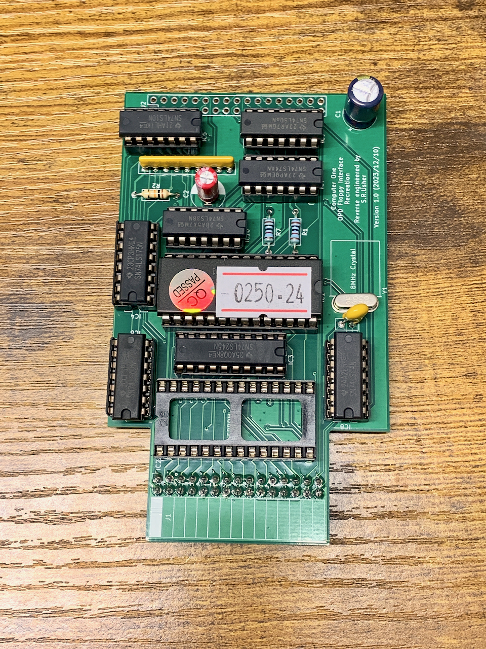

I made up a board...
It's a bit tall...

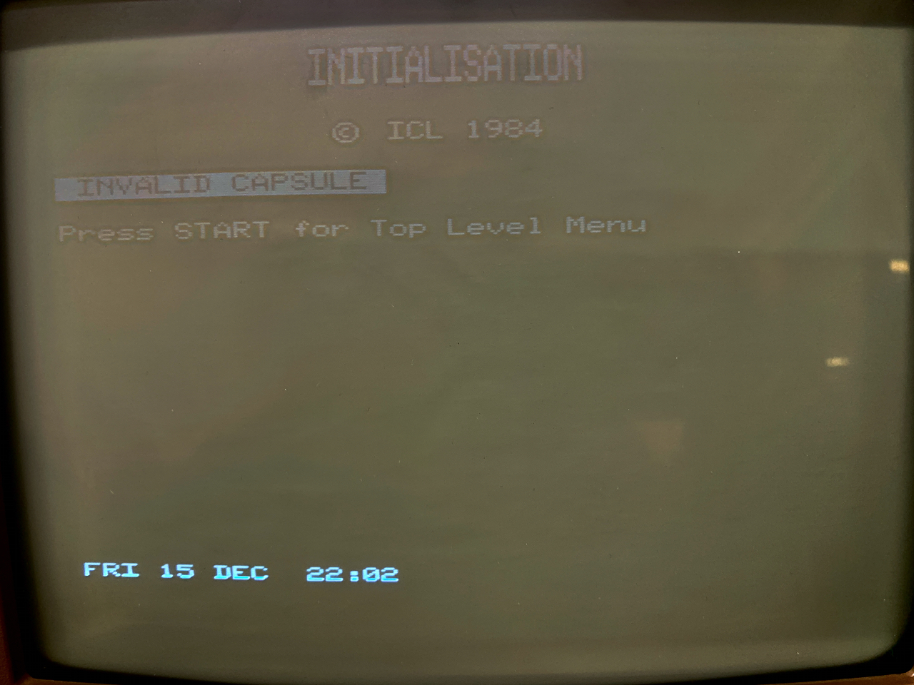

Promisingly the system sees the card and gives the BAD CAPSULE error, as it should if there's an invalid (or non-existant) ROM.
As suspected, the clock circuit just doesn't work. So, I'm going to have to hack together one based upon one of the reference circuits I can find on-line.
It's a bit tall...

Actually, I'll just buy a crystal oscillator can and use that.
