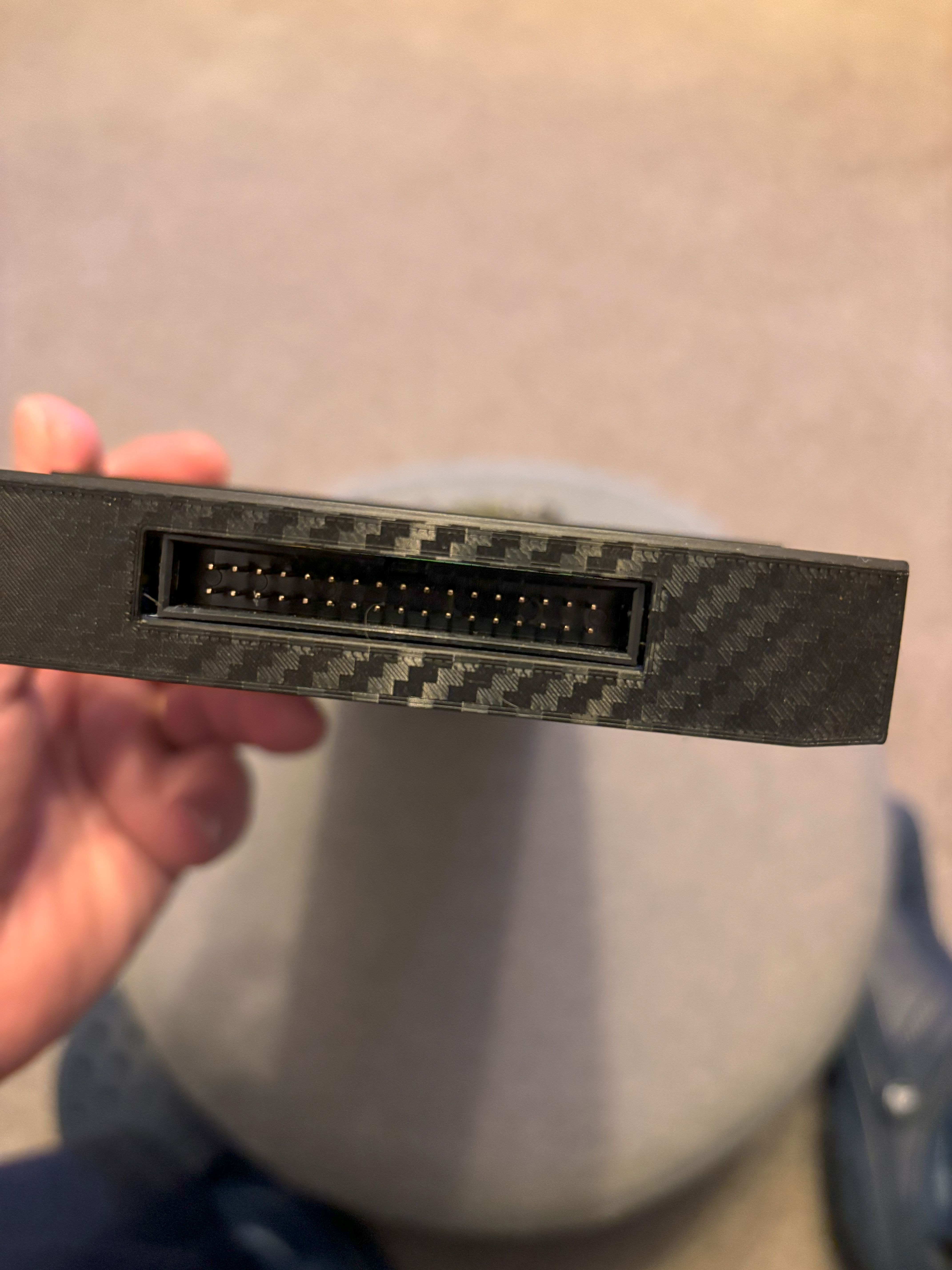

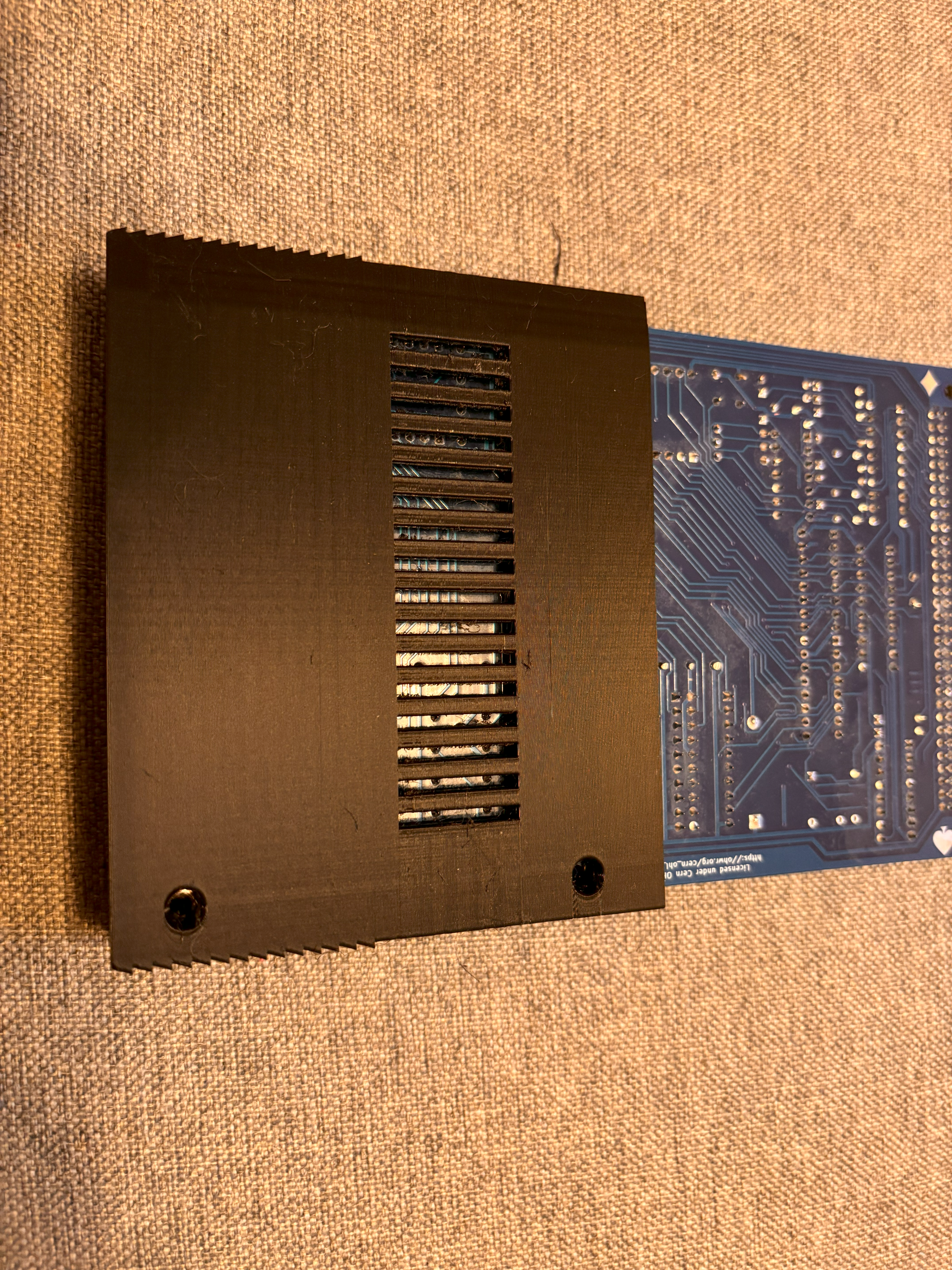

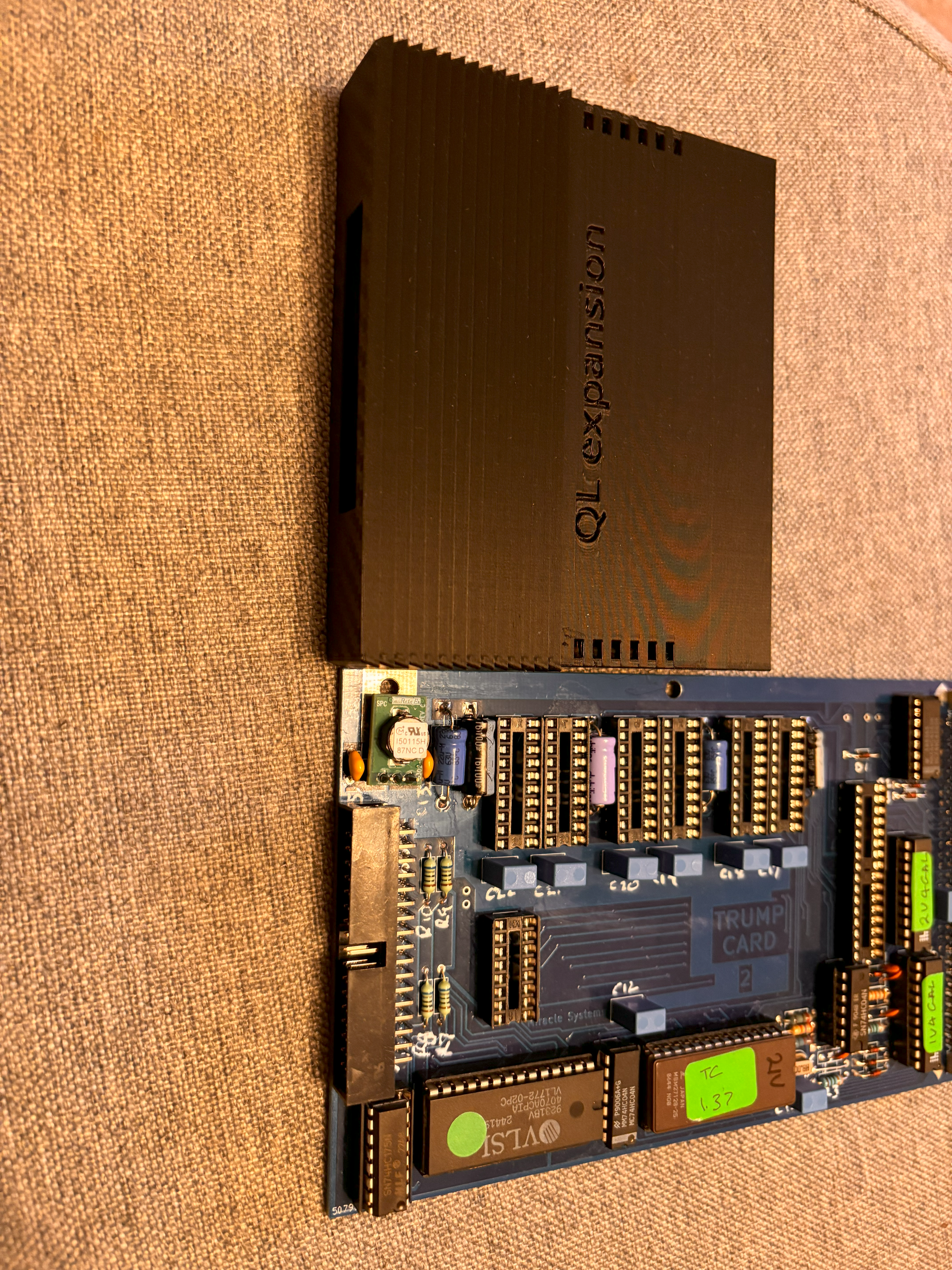

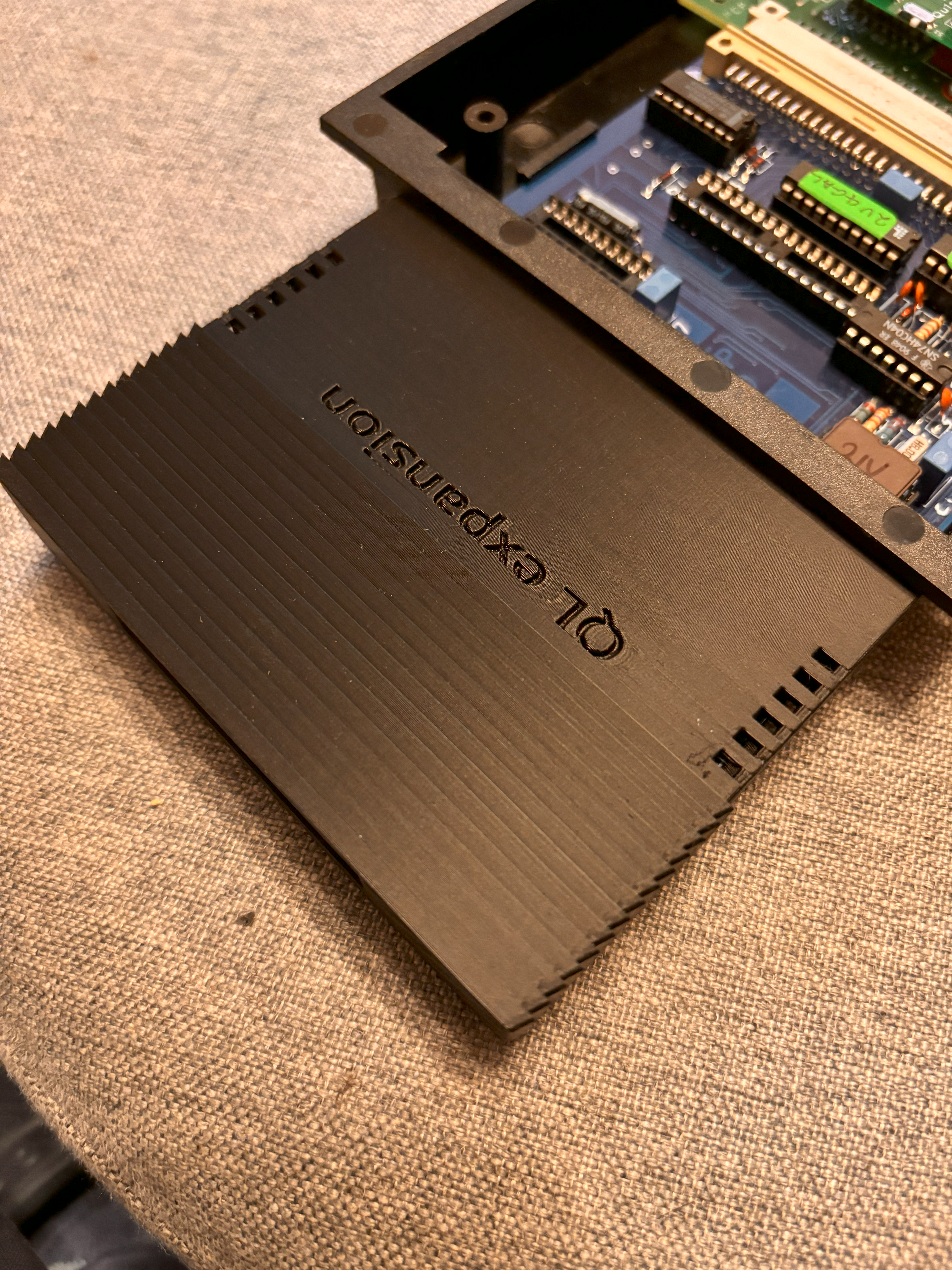

Here is the STL and some photos of my TRUMP 2 card expansion cover. Hope people like it.
Note that you will need to fit a modern switching regulator as there is no room for a heat sink or even a 7805.
Mark
