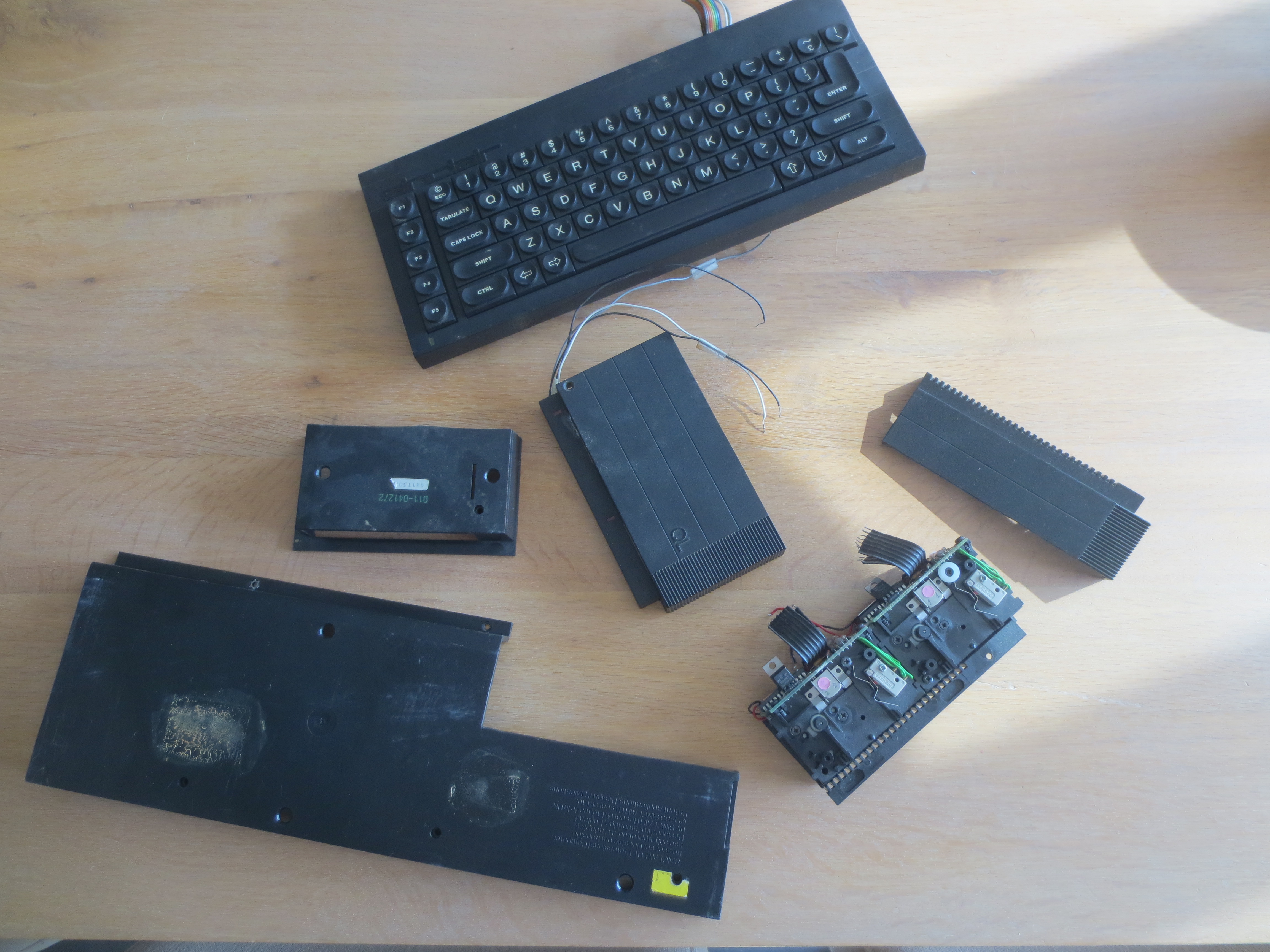

This is after i threw away all wood , dangerous electrics and household sockets and wall-switches .
It looked a bit like this ;
there was a double diskdrive and the owner had taken out the hdd and interface which he had already sold .
the part with the microdrives was used as one-unit so that fitted back rather nice , but the left side of the bottom has been sawed to fit the woodenbox he made , so the sizes were way off .
all was sawed by hand , so not a single straight line an partly re cut to make it fit the wood apparently , and glued to the wood with construction glue - Tec7 - .
so i had to put in more plastic to widen the case to fit the original top-cover , and make everything straight again .
after that i could only rattle-can spray it , looks terrible ( too glossy to my taste , but there is no semigloss clear varnish )but with the topcover on just does the job .
so what am i missing ,
all screws but i can compare to the other ql's i have
all rubber grommets to hold the feet ( feet are 3d printed already ) .
all small plastic covers , but a can 3d print those

Yep , that was the build progress.
due to a hdd failure i don't have pictures of the wooden unit anymore , but i can tell you most people would have put it straight in the bin .
the main pcb was "adapted" with electrical wire , and all connectors removed and replaced by extension cables to new connectors ( so it really looked a mess ) .
i have replaced all cables , cleaned the pcb ( mouse house for a decade ) and then re-soldered the connectors .
main pcb works as it should now.
- btw , found a rattle-can matt clear varnish , and now it looks the thing ( matches the top half 95 % )

if everything goes well , it should look ( from the top ) like a normal ql .
if tried to use some filler on the bottom , but all fillers i could source are harder than the plastic , so sanding it down creates more problems .
so the bottom from the bottom looks far from original

Re: - solved - search for ql-speaker
I do not think a filler idea is going to work, you will need the same material to create a covalent bond to the two parts being joined.
The best method, I have seen on other internet sources is to melt plastic of the same type into the join where is it no noticeable and remove the excess, very hard to get a smooth join, but it seems not impossible.
it melts when heated so sure thermoplast .
i will see how the epoxy glue holds on ......and keep fingers crossed
