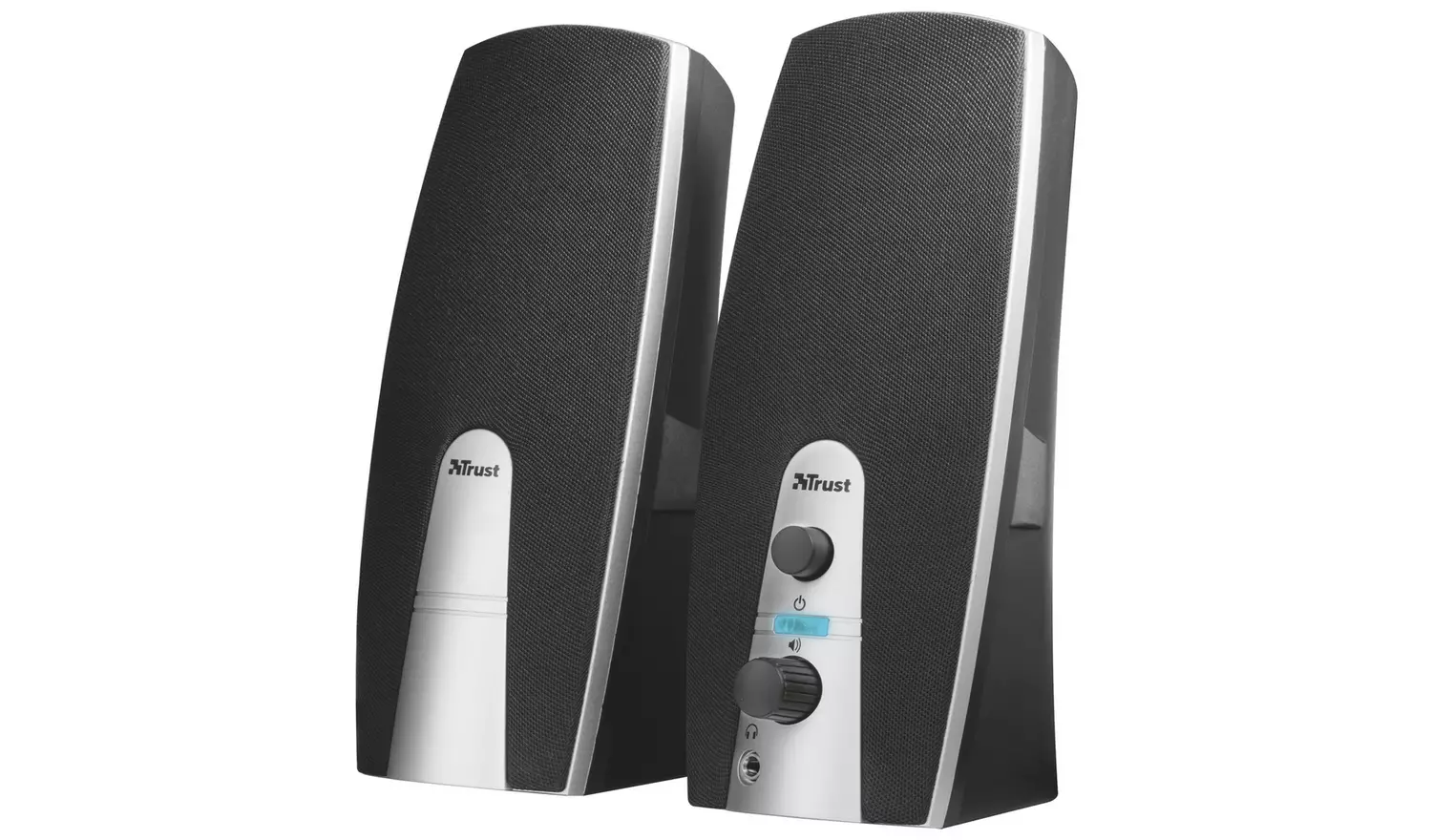

I'm still looking for an old stereo speaker I have somewhere to use with the Q68 to try out the sound. But starting to feel like I'm getting somewhere now.

For Speakers, I bought from ARGOS: Trust Mila 2.0 PC Speaker Set - Black and Silver: https://www.argos.co.uk/product/8651774 ... &GPDP=true
Re: Q68 WIN drives
Thanks Derek. If I can't find my old speakers, I might go for one of those. The second mouse I had happens to be black with silver buttons (I have a feeling you might have sold it to me years ago with an old laptop?), so the speakers might match well.
