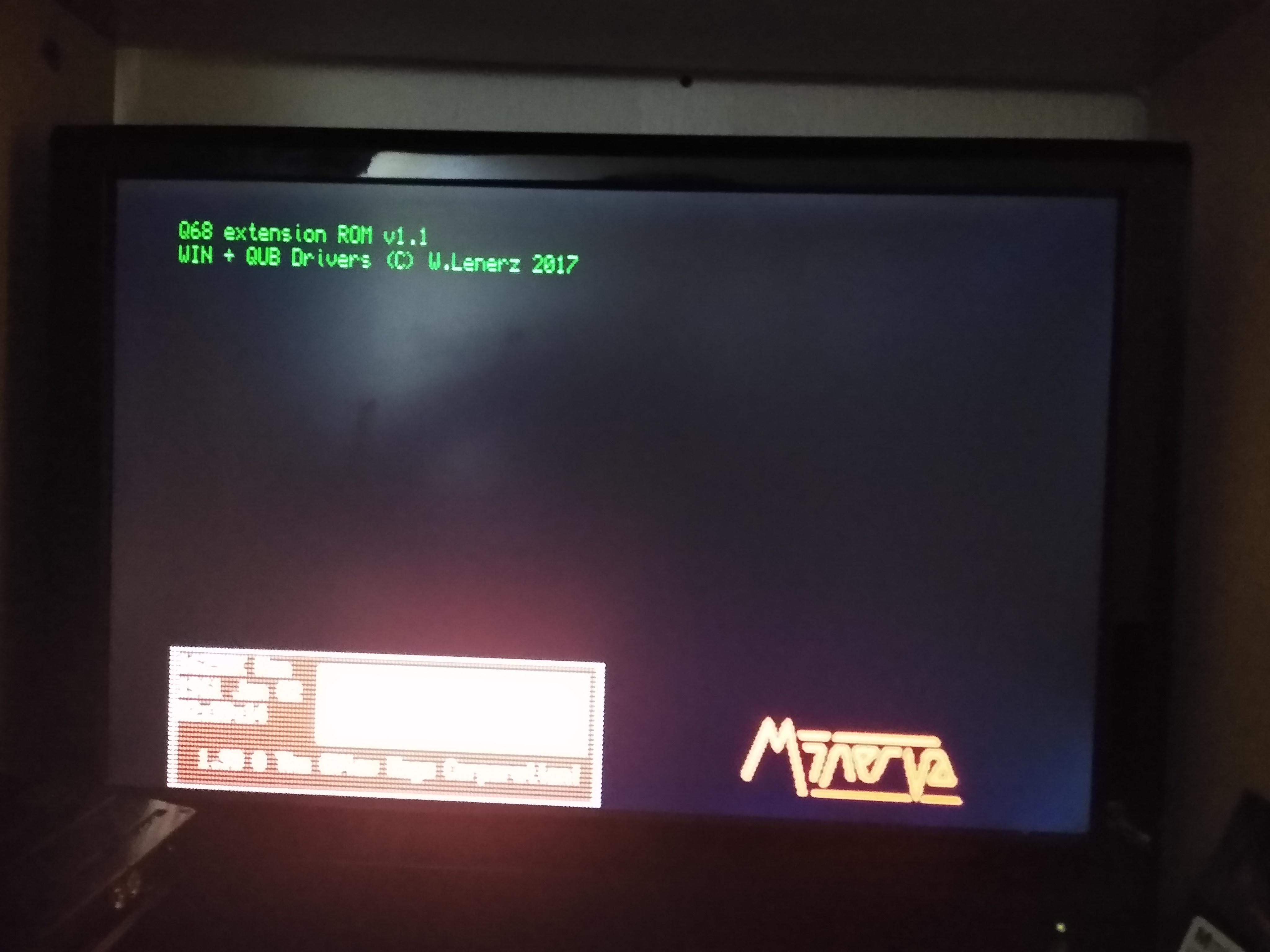

Re: Minerva4Q68 SD Card Setup
Need some help as to what I might be doing wrong with getting Minerva4Q68 to start up correctly.
I downloaded the Q68_xxROM.SYS files to my PC, renamed Q68_USROM.SYS to Q68_ROM.SYS (it's an American layout Perixx keyboard with '#' in place of UK pound symbol), checked its length (80K) copied it to a newly formatted SDHC card, added a couple of .WIN files, configured Q68_ROM.SYS for those .WIN drives on card slot 1 and tried it on Q68.
It gets as far as the Minerva splash screen, then locks up - unable to get it to proceed by pressing F1, F2 etc.
The keyboard works fine in SMSQ/E 3.38 on Q68.
I've also tried making Min4Q68_rext files to LRESPR from SBASIC on Q68, versions with and without Toolkit 2 versions from latest 2.36 to older ones (all exactly 16384 bytes in length). Exactly the same result - stops at the point of pressing F1/F2 to start Minerva.
I might be unlucky with the keyboard type not working with Minerva. Or Minerva might not be completing its startup. I don't know.
I'd appreciate any suggestions at this point to prevent me wasting more time if I'm doing something wrong.
Did that for SMSQ/E after Martyn's suggestion. I'll see if I can get a fast SD to try.Derek_Stewart wrote: Sat Jun 10, 2023 9:55 pm Hi Dilwyn,
Try changing the SD Card speed to 20Mhz, for SMSQ/E.
The Q68 Minerva rom, does not have a SD Speed option, so I will have look at this and get back to you.

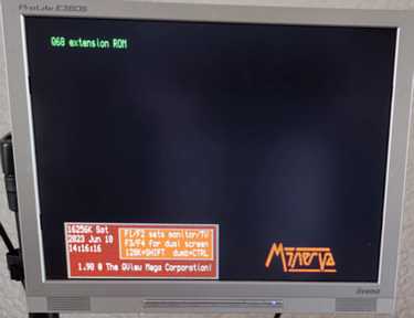

- Posts: 4796
Hi Dilwyn,
I created the FAT32 partition on the SDHC Card with Linux gparted, for the complete SD Card, and copied the Minerva4QDOS: Q68_ROM.SYS to the partition.
The Q68 booted into Minerva, waiting the system started in TV Mode as expected, rebooting, buy switching the power switch of/on, I can press F1 to go into Monitor mode.
Looking at your photograph, the Minerva OS is looking for another ROM. Sorry about the photo, I am not David Bailey...
I will try the booting from SMSQ/E and get back to you.
- janbredenbeek
- Posts: 685
Interestingly, the 'Q68 Extension ROM' message shows no version as it should (the newest version of 80K from my Working branch shows v1.2). Could it be that the machine keeps hanging in an interrupt routine, or perhaps the Q68_ROM.SYS is corrupt or not in contiguous sectors?Derek_Stewart wrote: Sun Jun 11, 2023 10:36 am Hi Dilwyn,
Unfortunately, the SD card driver is a 20K binary blob from Wolfgang Lenerz and I don't have the source of it, so fixing the timing issue would be hard to do. I believe this timing setting only applies to newer issues of the Q68? (My Q68 is from the first batch in 2017).
- Posts: 4796
Hi Jan,
The Q68 design has not changed. Only the operating system has changed.
I downloaded the working version of Minerva and copied Q68_UKROM.SYS to Q68_ROM.SYS into the FAT32 partition of a SD Card.
My badly photograph shows Minerva booting up correctly. I was also able to read the QUBide file from the QL-SD v1
