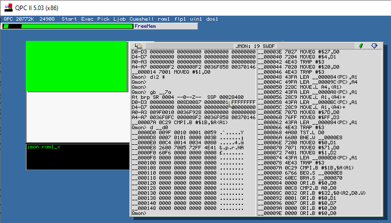

Posts: 2517
Re: IOP.SWDF - what does A1 point at please?
EDITED
Sorry about the delay.
Here's the code I was playing with which uses absolute addresses for the pointers to the sub window definitions, etc.
Interestingly, when tracing with QMON2, no errors are detected anywhere (makes a change for my code!) but when IOP.RPTR returns, no matter where in the window I press a key or click a button, I always get the pointer record telling me I was in the main window (-1 at offset 4 in the pointer record) and the chosen SLEEP pointers never appear no matter where I move the pointer.
iop.swdef.asm.zip
(1.14 KiB) Downloaded 79 times
mk79
Posts: 1349
Location: Esslingen/Germany
Post by mk79 »
sub1       dc.l    0               Pointer to sub windows pointer table
           dc.w    196,20,2,2      w,h,x,y  (x,y relative to main window)
sub2       dc.l    0               Pointer to sub windows pointer table
           dc.w    196,20,2,78     w,h,x,y  (x,y relative to main window)
What are these null pointers about? If you remove them your code will magically work. At least I see the mouse cursor changing shape on the top and bottom of the window.
mk79
Posts: 1349
Post by mk79 »
As expected the pointer record returned is also correct (clicked on the lower area and it returns 1 in __D4) :-)
Posts: 2517
mk79 wrote:What are these null pointers about? If you remove them your code will magically work. At least I see the mouse cursor changing shape on the top and bottom of the window.
I knew it was all my fault! :(
Those nulls are a result of copying and pasting the main subwindow definition but including the pointer to the other sub windows immediately above it. I truly am a dork!
When you mentioned NULLs before, I thought you were on about the actual subwindow list table, which I set up with dummy null pointers to be filled in later. My mistake.
Thank you very much for spotting my non-deliberate error and sorting me out. Much appreciated, thanks.
