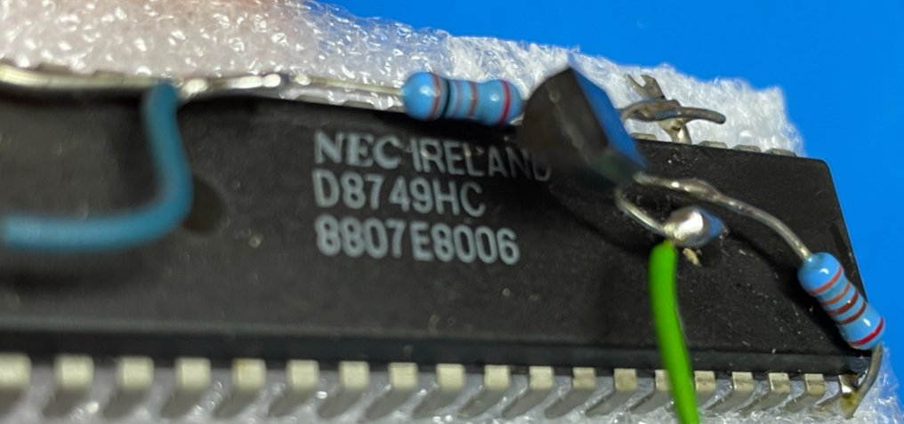

I got rid of the paper sticker that was on - doesn't look like it has any programmability to me, but according to the data sheet this guy includes "2K x 8 UV erasable EPROM". not sure exactly how the UV is supposed to get in! :)
At any rate, not a Hermes, which I'm slightly annoyed about after being all excited. Where does one find those these days?
Posts: 3154
Re: "8749 replaces 8049" Curiosity
This actually is a NEC8749H - which contains an EPROM, the OTP (one time programmable) version. Didn't know this existed.
