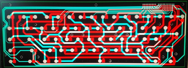

The hacking job became a bit complex so I have the hacked bits but now have to put them back together and I shelved it for now.I had a brain wave and a free day for a replacement membrane that isn't and here is the PCB layout. I wonder if you recognise it. It requires checking and it might be tricky to build but it only requires manual labour no thought. :)

Does the membrane keyboard require debounce because I could add a 1mS RC or something to the PCB if the software reading of the lines in the QL is rubbish?

Not sure who has been banned or why. It must have been something really evil with warnings and upset everybody on the forum for such drastic action. :| Thanks for the Hall effect Pinouts that I wasn't sure about how to connect to the QL. I found confusing pull down resistors on the 6 matrix lines perhaps to help the 8049 processor to read a good low signal. Ideally I wanted to put the Hall effect keyboards in the QL but many reasons prevent that so I have shelved it for now and done the above PCB so I can keep the original look and fit a PCB where the membrane sits. Well that is the plan and the system is tweakable like bridge tuning a guitar so it should work in the end.
