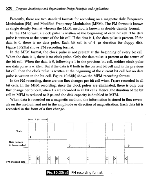

Anyone know the encoding format of the Microdrives ?
So far I have found the circuit diagrams and the sector format but how is a single bit encoded on the tape ?

Hello Gertk,
this is 100kHz FM encoding.
I had done some work on it here:
http://www.theqlforum.com/viewtopic.php?f=2&t=269#p1616
Unfortunately the image I had uploaded to the forum is gone !?
(I am sure I had not put an external reference to the image.)
Greetings,
Vassilis

Would the data format/encoding be something like this:
FM
FM
