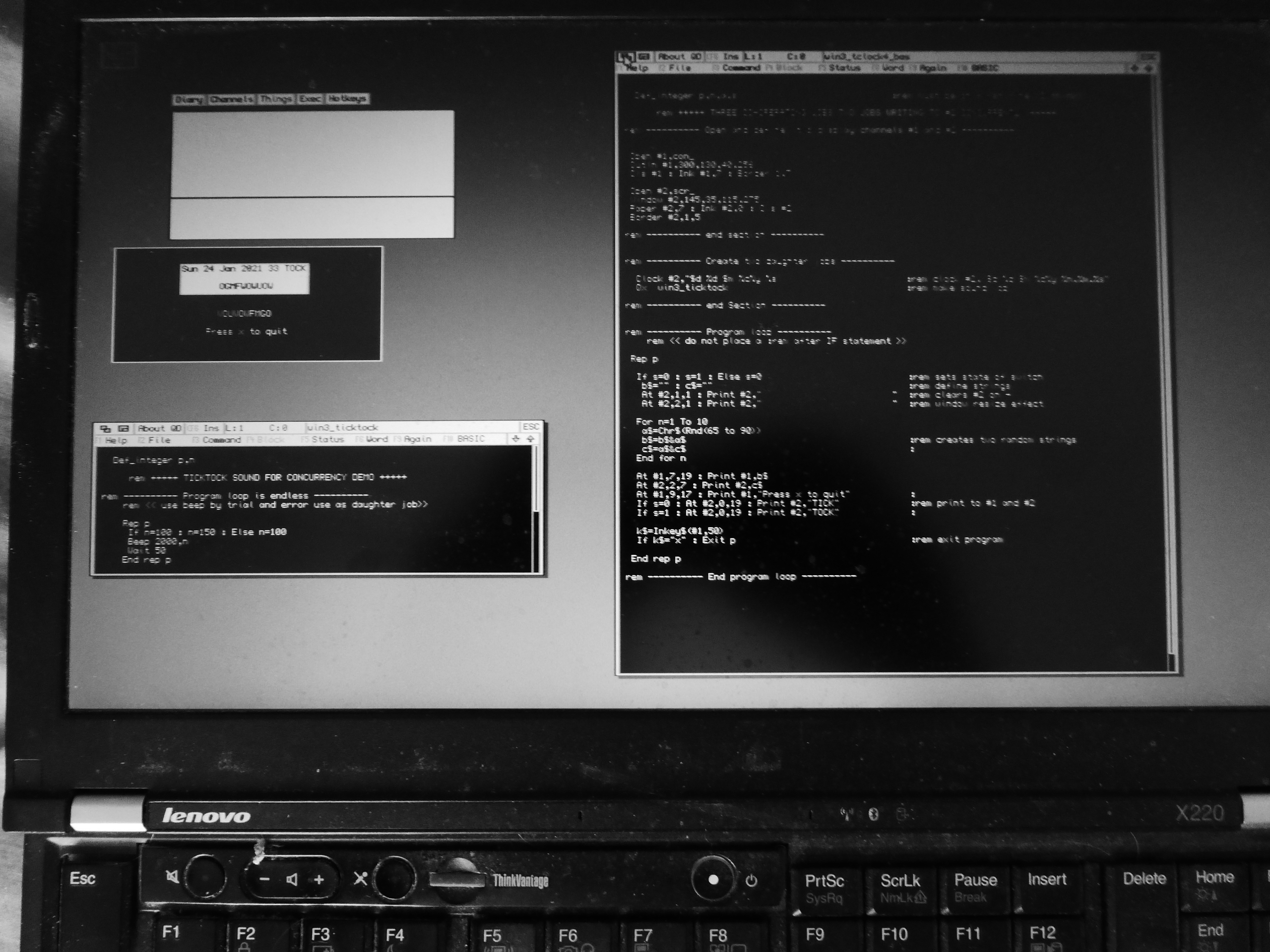

I have finally written a program that actually works demonstrating two jobs writing to channel #2 concurrently.
I have, though, cheated a bit by using the multitasking job "clock" to prove a point. The program shows that
concurrent writing is technically possible but with one job written in assembler. What CLOCK does to make this possible is not
knowable by me.
The program demonstrates two daughter jobs and two channels working in the QD way. The jobs and channel menus show
correct operation. Both programs need to be compiled with windows turned off and the sound program needs to be referenced
according to its file name.
The sound job uses the keyword WAIT because PAUSE opens a channel by default thus damaging the display.
I have tested the demo in QPC2 and find that it works just as well as in a Q68.
I don't really know how to send the WAIT code on this forum. The code I have attached were .rts or .cde files.
When I tried to attach the files I got an error saying wrong file type, also don't know how to convert an SMS screen image such that I can post it on this
forum so I have taken a photograph of the display instead.
The Photographs shows the source code in two QDs and the resulting compilation in a small window on the left. The Laptop is an elderly Lenovo X220.
The code for the main job is as follows:- Note the rems have all appeared in the wrong place. See rubbish photo for correct layout.

Def_integer p,n,a,s :rem must be on first line (I think)
rem +++++ THREE CO-OPERATING JOBS TWO JOBS WRITING TO #2 CONCURRENTLY +++++
rem ---------- Open and define two display channels #1 and #2 ----------
Open #1,con_
Outln #1,300,130,40,256
Cls #1 : Ink #1,7 : Border 1,7
Open #2,scr_
Window #2,145,35,115,275
Paper #2,7 : Ink #2,0 : Cls #2
Border #2,1,5
rem ---------- end section ----------
rem ---------- Create two daughter jobs ----------
Clock #2,"$d %d $m %c%y %s" :rem clock #2,"$d %d $m %c%y %n.%m.%s"
Qx win3_ticktock :rem make sound job
rem ---------- end Section ----------
rem ---------- Program loop ----------
rem << do not place a :rem after IF statement >>
Rep p
If s=0 : s=1 : Else s=0 :rem sets state of switch
b$="" : c$="" :rem define strings
At #2,1,1 : Print #2," " :rem clears #2 on -
At #2,2,1 : Print #2," " :rem window resize effect
For n=1 To 10
a$=Chr$(Rnd(65 to 90))
b$=b$&a$ :rem creates two random strings
c$=a$&c$ :
End for n
At #1,7,19 : Print #1,b$
At #2,2,7 : Print #2,c$
At #1,9,17 : Print #1,"Press x to quit" :
If s=0 : At #2,0,19 : Print #2,"TICK" :rem print to #1 and #2
If s=1 : At #2,0,19 : Print #2,"TOCK" :
k$=Inkey$(#1,50)
If k$="x" : Exit p :rem exit program
End rep p
rem ---------- End program loop ----------
The code for the sound job is as follows:-
Def_integer p,n
rem +++++ TICKTOCK SOUND FOR CONCURRENCY DEMO +++++
rem ---------- Program loop is endless ----------
rem << use beep by trial and error use as daughter job>>
Rep p
If n=100 : n=150 : Else n=100
Beep 2000,n
Wait 50
End rep p

Tinyfpga wrote:The sound job uses the keyword WAIT because PAUSE opens a channel by default thus damaging the display.
Thats what SMSQ/E's inbuilt keyword SUSJB is for
I don't really know how to send the WAIT code on this forum. The code I have attached were .rts or .cde files. When I tried to attach the files I got an error saying wrong file type,
Only a few filetypes can be uploaded here. Zip is the most common: You need to Zip the file.
I also don't know how to convert an SMS screen image such that I can post it on this forum
On Windows you can use the PrtScr key combination, to copy a screen to the Clipboard. Then use Paint to crop and save the image for uploading. On the Q68 you could use Snip (off Knoware.no) and then convert the PIC to JPG (with QTImage, for example).
Wrap your code in {code}{/code} tags (using square [ ] brackets!)
I think youll find that CLOCK on its own proves the point: Invoking CLOCK starts a channel-less job, that writes to a channel owned by the job that invoked it.
The only way I can think of doing what you are trying to do, is to have access to the other job's real channel ID and finding a way of sending IO to it. This can only be done using machine code, either via a job (as in CLOCK) or via a toolkit, as in my example, above.

PS: You can see the PrtSc key of your laptop on your photo, above. Just to the right of the middle of the image.
