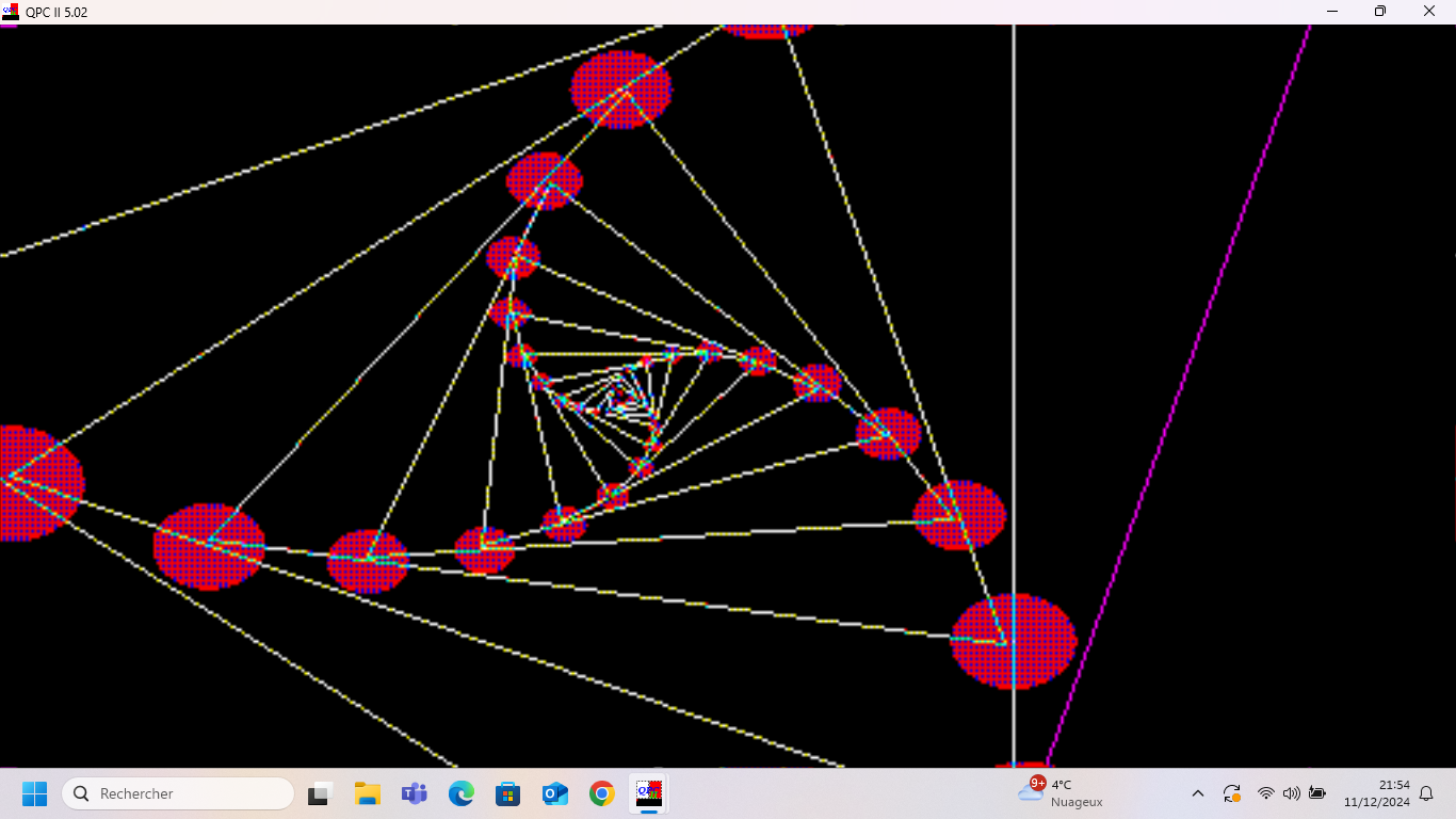

stevepoole
Posts: 909
Re: Doodle - TriGons
Post by stevepoole »
Hi Folks,
Just a little animated Doodle before Xmas looms up....
Triangular_Spirals.zip
(502 Bytes) Downloaded 78 times

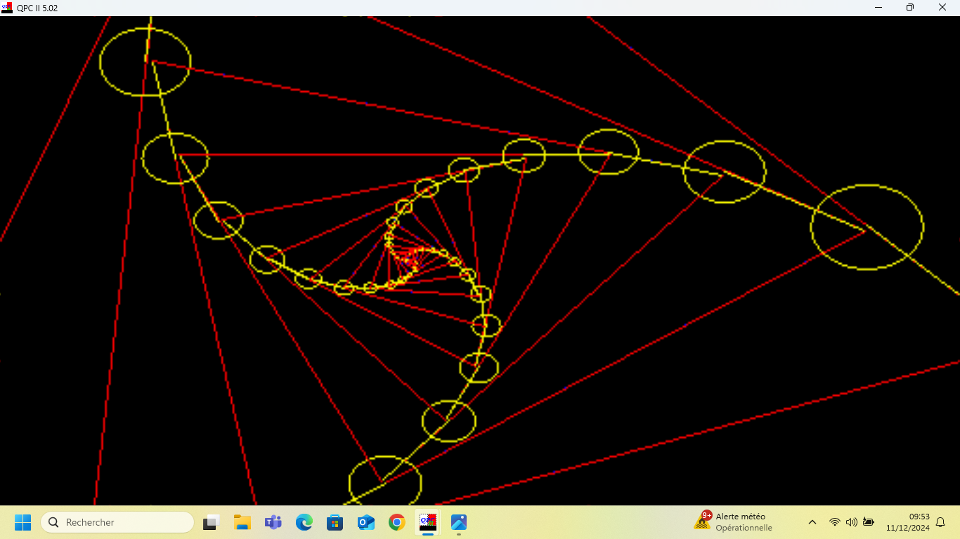

stevepoole
Posts: 909
Re: Doodle - the firefly
Hi ,
New slightly improved version...
stevepoole
Posts: 909
Yer Tiz... Tested Ok on QPC2, and SGC under QDOS - Quite fast.
Triangular_Spirals2.zip
(542 Bytes) Downloaded 98 times
